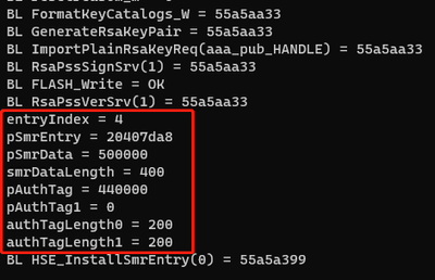

Hi NXP,
I am trying to use C code to test SMR install API(service ID:
HSE_SRV_ID_SMR_ENTRY_INSTALL
), However, I always got service response A5AAA399 which meas parameter is incorrect.
there is so many Argument in this API, could someone help me to check?
the signature and address have benn vailded is this test.
the HSE FW version is  0.2.6

JasonChou
Moreover, I print arguments before send HSE. I'm not sure if it is any help.

Hi @lukaszadrapa,
Thanks for reply,
sorry for missing definition of argument. this parameter(test_sign_real) is follow on demo code(hse_secure_boot.c), here is the definitions
My test code
#define app_start_real             0x500000UL
#define test_sign_real             0x440000UL
#define test_HANDLE         GET_KEY_HANDLE(HSE_KEY_CATALOG_ID_NVM,3,0)
static const uint32_t tag_addr[2U][5U] =
    {0, 0, 0, 0, test_sign_real},
    {0, 0, 0, 0, 0}};
static const uint32_t tag_len[] =
        16U, 16U, 16U, 32U, 512U};
#define RSA_TAG_CODE_FLASH_ADDRESS 0x00454100UL
        {CMAC_TAG_CODE_FLASH_ADDRESS, GMAC_TAG_CODE_FLASH_ADDRESS, HMAC_TAG_CODE_FLASH_ADDRESS, ECC_TAG1_CODE_FLASH_ADDRESS, RSA_TAG_CODE_FLASH_ADDRESS},
        {0, 0, 0, ECC_TAG2_CODE_FLASH_ADDRESS, 0}};
        16U, 16U, 16U, 32U, 256U};
Basically, It's the same except the value.
I try demo code in Trace32, and it's work, but I still don't know the different between my test code and demo code...

lukaszadrapa
Hi @JasonChou
it's core registers, so it's described in the core manuals:
http://infocenter.arm.com/help/index.jsp?topic=/com.arm.doc.ddi0489d/index.html
http://infocenter.arm.com/help/index.jsp?topic=/com.arm.doc.dui0646b/index.html
hseSmrEntry_t (your SmrEntry[4]) has more items which I can't see in the code. You can find details in API RM. Could you check how those items are initialized?

lukaszadrapa
Hi @JasonChou
SmrEntry[4].pInstAuthTag[0] = test_sign_real; /* signature tag address */
This should be a pointer to the signature only, not directly the value. Could you check this?
