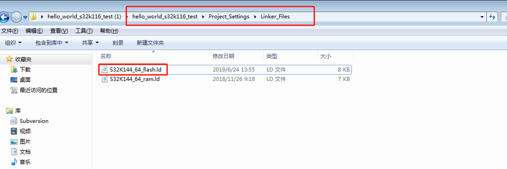

jiri_kral
the linker file used in project is missing - it looks that it is linked from your hard drive.
Jiri
6,207件の閲覧回数
jinshuaixu
Contributor V
     In project,link file is exist,please check the project again,thank you
