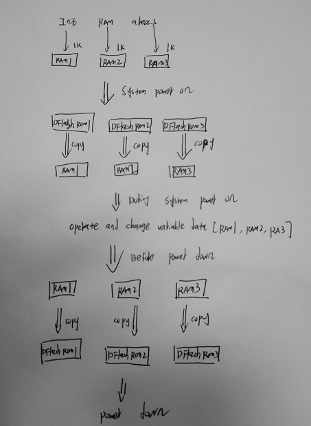

     Now, I  meet a question .l want to partion S32K116 chip RAM address to several ereas to storage variable.the question is : In debug mode, l  initialize RAM1  area  variable ,the project run sucess.In not debug mode, I initialize RAM1 area variable ,when the project run to set RAM1 area variable (  RAM1_TEST1=1;), the chip will reset. just as bellow :
     l think the question is l have setted "S32K1xx_flash.ld" file wrong.please tell how to set "S32K1xx_flash.ld".

    the reason why l need to partion RAM to several area is that l want copy DFLASH store data to RAM after system  power on. During system power up,l will change RAM area variable data.Before power down, l will copy data from  RAM to Dflash. the variable is too much ,so l can not copy data one by one, l need oprate it batch.

the best option is using Emulated EEPROM - if your data can fit into 2kB size. Here is simple example - https://community.nxp.com/docs/DOC-340114 and store your data into structure for example.
Otherwise you need to crate some memory management by yourself - something like "save" function where you can specify RAM start address  and RAM end address and store this area into dflash.
Jiri

     l need two RAM area, each area need 2kB size,l am so tangle for this problem.
