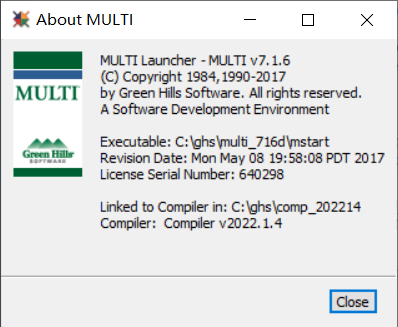

WeiCh
I'm using the GHS compilation project and reported a lot of errors, but the console and problems pages do not show the specific cause of the error, unlike GCC compilation, which prompts the cause of the error. Where can I configure it?

jiri_kral
which version of S32DS and GHS plugin are you using? Can you please share full output from build console?
3,463 Views
WeiCh
S32DS version is 3.5,GHS is 202214:
