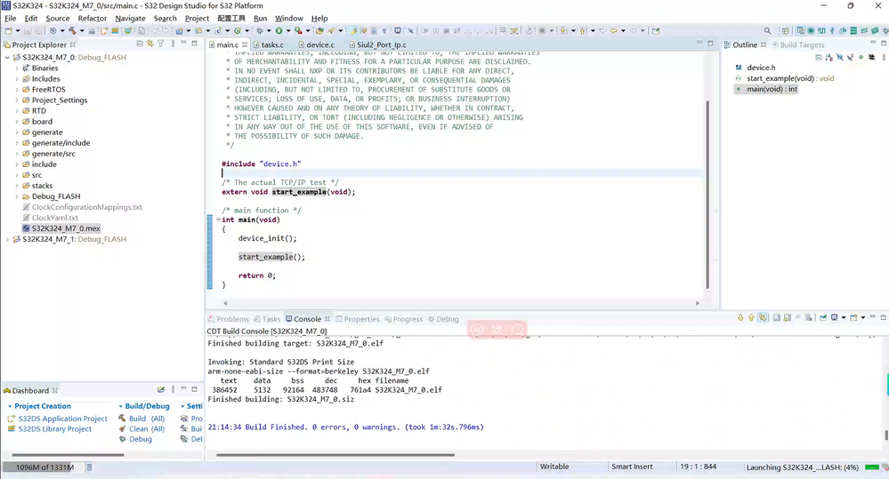

S32DS3.4 could open mex, and compile ok, but the component show error flag
1,119 Views
CherryDeng

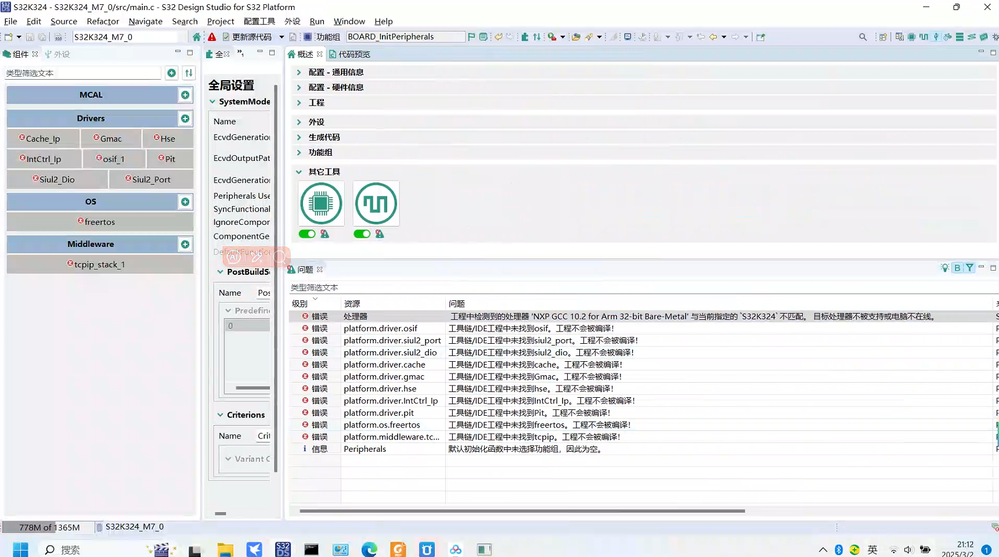

S32DS3.4 could open mex, and compile ok, the project could work well, but the component show error flag as below picture, could you help check it? Thanks.

I also got the same error message after importing the project you sent me:
Issue: Processor '' detected in NXP GCC 10.2 for Arm 32-bit Bare-Metal project does not match with currently selected 'S32K324'. Target processor not supported or the computer is not on-line.
Level: Error
Type: Tool problem
Tool: McuConfiguration
Origin: S32K324_M7_0
Resource: Processor
Information: -

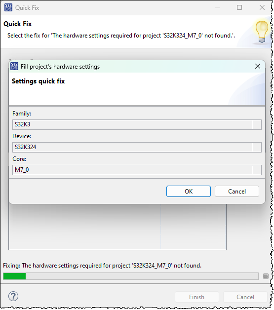

Description	Resource	Path	Location	Type
The hardware settings required for project 'S32K324_M7_0' not found.	S32K324_M7_0		S32K324_M7_0	S32 Project Version Problem
It is recommended to repair projects 'S32K324_M7_0' and 'S32K324_M7_1' through Quick Fix:
Quick Fix Issue Processor '' detected does not match Target processor not supported The hardware settings required for project not found.pngSetting quick fix.png
