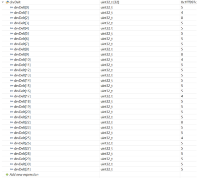

Ported old project on For Arm 2.0  platform to S32DS 3.4 Platform, but found the scheduler not triggers the task on time.
xTaskCreate( InitJobTask, "IK", 512 , NULL, mainQUEUE_SEND_TASK_PRIORITY + 8, &Rt_InitTaskxHandle); // Init Task
xTaskCreate( DrvTask, "TH", 512 , NULL, mainQUEUE_SEND_TASK_PRIORITY + 11, &Rt_DrvTaskxHandle );
vTaskStartScheduler();
static void InitJobTask( void *pvParameters )
     for( ;; )
        SystemInit();
      vTaskSuspend(Rt_InitTaskxHandle);
uint32_t drvt1 = 0;
uint32_t drvt2 = 0;
uint32_t drvDelt[32] = {0};
static void DrvTask( void *pvParameters )
    static TickType_t xLastWakeTimeMs;
    int i = 0;
    xLastWakeTimeMs = xTaskGetTickCount();
    for( ;; )
         drvt2 = GetTimeStampTimeMs();
         DrvTask();
         drvDelt[i] = drvt2 - drvt1;
         drvt1 = drvt2;
        i += 1;
       if (i >= 32 )
          i = 0;
      vTaskDelayUntil( &xLastWakeTimeMs, 5);
Debug result:
but the old project on For Arm 2.0, works well.
Did anyone meet similar issue before?  i don't know how to fix it now.
