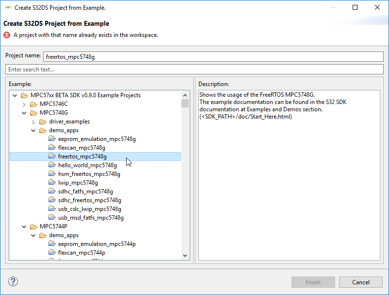

HI
I am using S32DS for MPC5748G dev kit.
I opened S32DS new project. I added FreeRTOS module in to project from components library.
Then generate Processor expert code.
But while runing, code get struct int IVOR1 handler.
When i paused code, i observed control in IVOR 1 handler In assebly code.
I have read other thread related to IVOR 1 related, but didn't get clear idea
So please help me to sort out this problem. For more information i have attached code file.
Laxmikant
1,989 Views
jiri_kral
at first look on your main.c - there is no clock init. Also it looks like that the PEX_RTOS_INIT macro (where may be clock init) is not defined too.
Anyway - good starting point is FreeRTOS example - part of SDK:
Hope it helps.
Jiri
