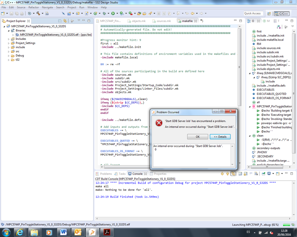

find this error:
We are using MPC5777MEVB evaluation board with MPC5744P microcontroller. We connect through PE Micro Universal Multilink and have installed latest version of its drivers. Apart form this, we have installed lastest version of S32 Design Studio.
Any help on this issue please?
Thanks in advance.
Maite

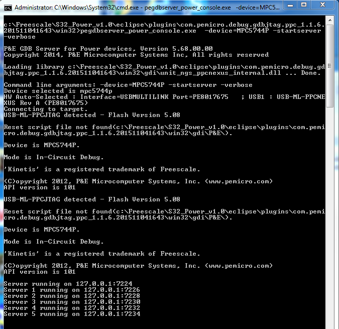

Could you perhaps start Pemicro GDB server from the command line -  it should show some more info about the issue.
Go to folder and execute the command below from the Windows command line:
c:\Freescale\S32_Power_v1.0\eclipse\plugins\com.pemicro.debug.gdbjtag.ppc_1.1.6.201511041643\win32\pegdbserver_power_console.exe  -device=MPC5744P -startserver -verbose
If the connection is successful you should see something like this:
Could you please post your terminal window In case there is an error?
Thanks!
Stan

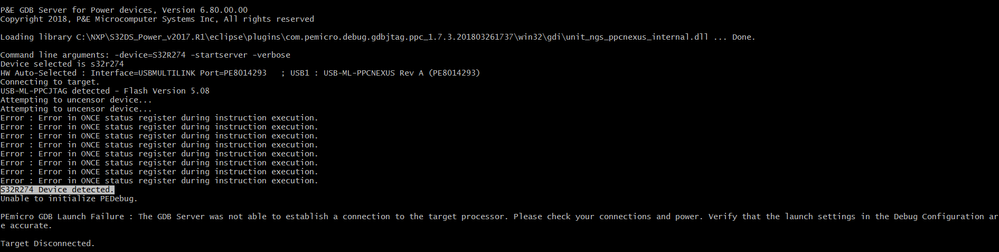

I am facing similar issue. Could you please take a look at my screenshot and let me know what I am missing.

According to the log it seems that the device is censored or there is a "hardware" kind of issue that prevents accessing JTAG OnCE registers and connectiong to the board.
Have you programmed UTEST flash on your device (e.g. dcf records) ?
Have you ever been able to connect to this board using your setup (board + probe + S32DS)?
Which board and MCU mask are you actually using?
I noticed you are connecting via pretty old Pemicro probe. Do you have any other probe to test with (to eliminate faulty probe unit case) or any other MPC57xx board you can test with the probe you have?
Also I'd strongly recommend you to update S32DS. There is new version of pemicro plugin available (v1.7.4) and a  Radar SDK which you might find useful:

1. The board was a new S32R274 that I was testing. As I had set the default configurations incorrectly (not enough delay after the reset and before communicating to target), hence the communication was failing.
2. I was not able to communicate to the chip at all. Did problem number1 cause this to happen?
