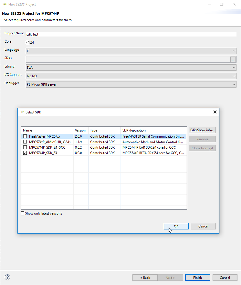

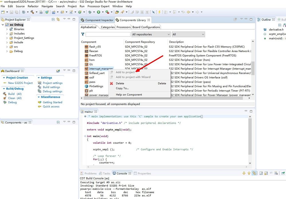

I'm using the DEVKIT-MPC5744P,my IDE is S32DS for Power Architecture 2017.R1;I cannot using PE in S32DS,the menu "add to project" is disable.
I can't find how to add component in PE.please help.
3,136 Views
jiri_kral
Your project is not based on SDK. The processor expert is part of SDK. You can add SDK when new project is created:

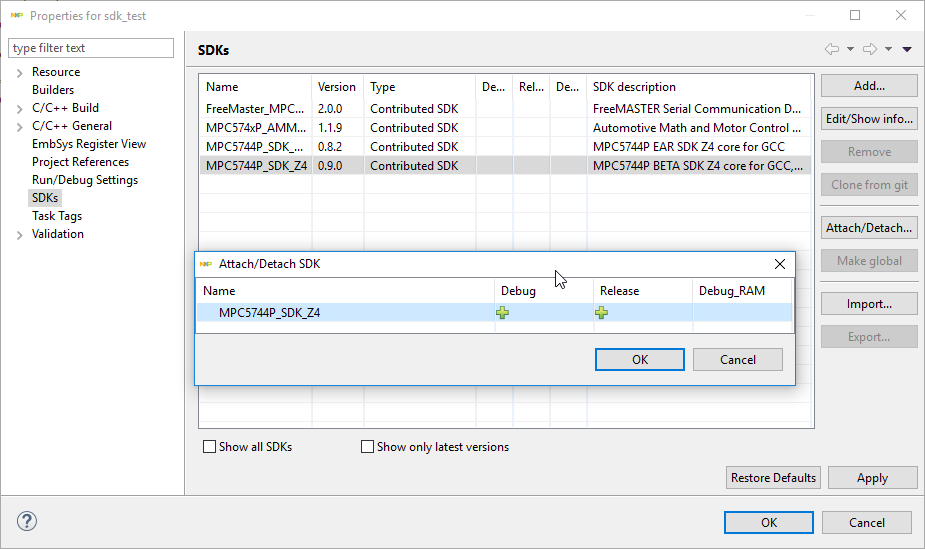

or you can add SDK in existing project as well (right click on project name -> Properties) :
When done, your project should look like this:
Hope it helps.
