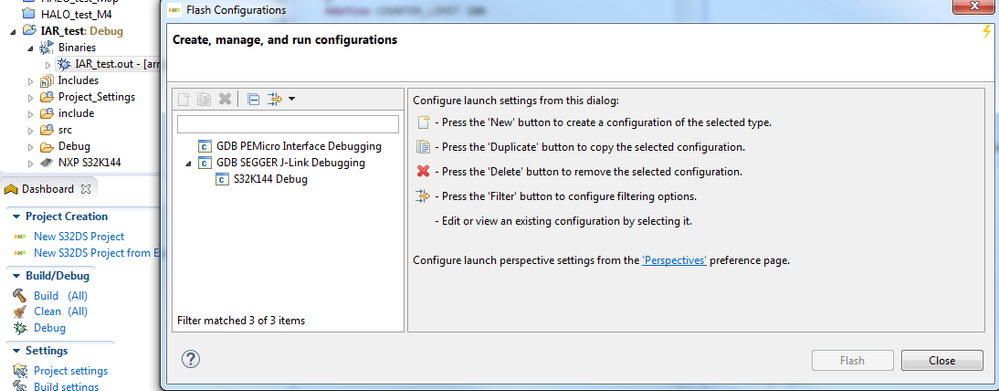

I'm using the S32 Design Studio with the IAR plugin, but in the Flash Configurations screen, the IAR C-SPY Application option does not appear, as it appears on the debugger screen. How do I enable this option to Flash?
Please, a need a feedback asap.

You are right I've just reproduced. Indeed IAR C-SPY Configurations are missing in "Flash Configurations". I've submitted a defect ticket. Unfortunately I'm not aware of any workaround other then use debug configurations to program your binary file.

Stan, thanks for your feedback.
Because of this, I used SEGGER Jlink to program my MCU.
I was not able to use SEGGER because the version of my Flasher was outdated. Updating to version 6.14 of Jlink was ok, now I can program my MCU.
