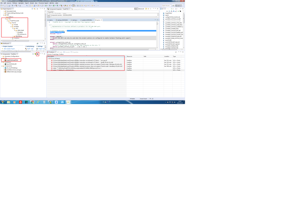

hello:
when i added freertos component to any new S32DS1.3 Project, when i pressed the  generate the processor expert code  icon, i built the project ,but the project couldn't pass ,and it remain as the below errors:
i dont know what s wrong in my project ,Could you help me confirm it?

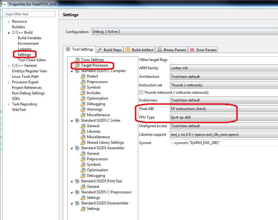

Hi Felix,
It seems the project has no floating point support enabled.
Please go to project properties -> C/C++ Build -> Settings -> Target Processor and set Float ABI to "Hard" and FPU Type to "fpv4-sp-d16"
Stan

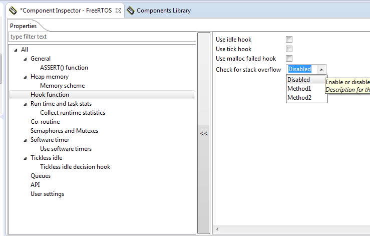

I'm able to reproduce this issue. I'd suggest you:
1) enable Floating point to Hard
2) disable StackOverflow checking (see the screenshot below) and generate the code again. This option is enabled by default and in such case the project expects a callback function associated with this event (stack overflow) to be created by user. So you can either create this callback function or completely disable stack checking to pass the build.
3) I noticed there may also appear some false positives messages in Problems View. So I'd recommend you to clean the project and Rebuild the indexer (right click on project -> Index -> Rebuild).
FYI:This is a know issue which should be addressed in a next releases.
I'd recommend to you to check result of build in the console view and if the elf file is generated and you observe an errors in Problems View then these errors are false ones.
Hope it helps.
Stan

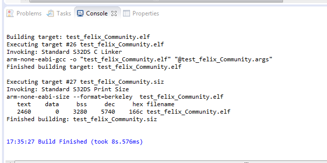

felix-li
hi, Stanishlav:
thanks for your help, i have  finished the compile successfully as your  way.
