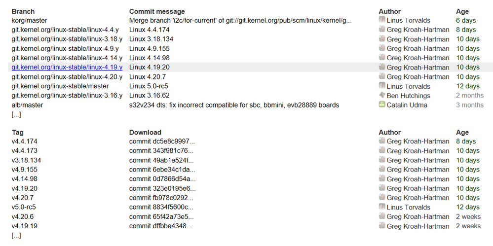

435761040
Fresh Out Contributor
Yes, the problem is solved after the patch is finished.
But reported when applying vsdk demo
Bus error .
I can determine if it is a kernel or a device tree.
My kernel is
Linux s32v234sbc 4.14.34-rt27-00002-g12135f4-dirty #4 SMP Fri Feb 15 10:07:37 CST 2019 aarch64 aarch64 aarch64 GNU/Linux
What I want to ask is, which is the bsp19.0 kernel branch corresponding to vsdk1.3?
According to the manual I git clone https://source.co deaurora.org/external/autobsps32/linux
Get the kernel of bsp19.0
But which branch of the branch corresponds to vsdk1.3?
Thank
