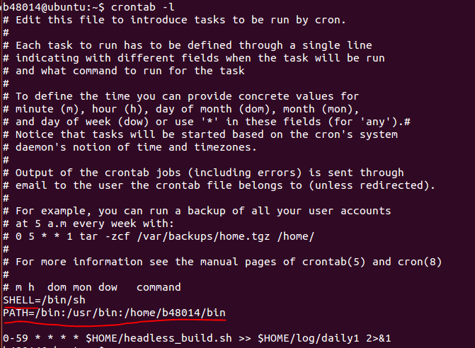

hello everyone,
I create a script as shown below to build my S32DS project, It can be successfully executed to generate  the final binary file.  but, when I use this script in cron to realize automatically and periodically build of S32DS project.  It failed and show lots of error.  I've pasted some of it as shown below.
 How could I use cron to build S32DS project?  I guess  the reason related to environment variables of
cron,  But I have no idea how to how to  specify  S32DS environment variables to cron?
 Any help  will be greatly appreciated.
#!/bin/bash
source /etc/profile
source ~/.bashrc
/home/jeremy/NXP/S32DS_Power_v1.2/eclipse/s32ds \
-vm /usr/local/java/jdk1.8.0_161/jre/bin \
-nosplash \
-application org.eclipse.cdt.managedbuilder.core.headlessbuild \
-importAll /home/jeremy/work/tmp/code_analysis/gateway/MPC5748g/MPC5748g_Z4_0 \
-cleanBuild MPC5748g_Z4_0/Debug_ImgA \
--launcher.ini /home/jeremy/NXP/S32DS_Power_v1.2/eclipse/s32ds.ini \
--launcher.suppressErrors

The problem here is the environment variables of cron is not correct set, but not SHELL and PATH.
I have already specified SHELL and PATH in ~/.bashrc, and sourced this file in script.
My solution is: I added  the following two variables in my shell script, then it work correctly with cron
export DISPLAY=:0
export SSH_AUTH_SOCK=/run/user/1000/keyring/ssh
Actually, I don't know exactly what does this two envionment variables mean.
Please let me know If anyone knows.
Thanks a lot.
3,695 Views
b48014
Well, actually, you have problem with cron configuration, not with Design Studio, but I will try to help you anyway. :smileyhappy:
Could you show me the output of crontab -l command?
Please note that you should specify SHELL and PATH for cron. This is my output for this command:
with the crontab file above I was able to build the project each minutes without any errors.
And I think you can use more simple version of headless build:
#!/bin/bash
source /etc/profile
source ~/.bashrc
/home/b48014/NXP/S32DS_Power_v2017.R1/eclipse/s32ds \
-nosplash \
-data /home/b48014/workspaceS32DS.Power.2017.R1 -build test/Release
the project was located in workspace - /home/b48014/workspaceS32DS.Power.2017.R1
project name is test, build configuration is Release
Dmitry
