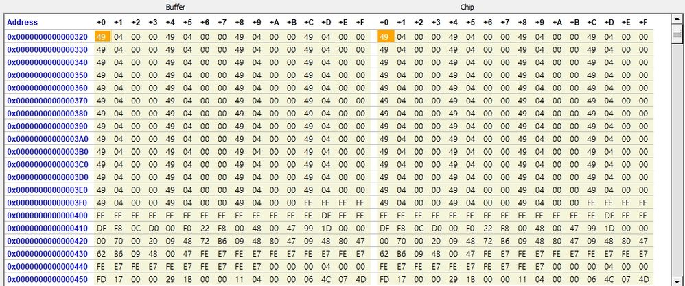

We tested the address 0x40D (FOPT Register) write 0x7F, after address 0x400 can not read
If 0xFF is written at address 0x40D (FOPT Register), it can be read correctly.
Kindly give us your advice. Thank you.

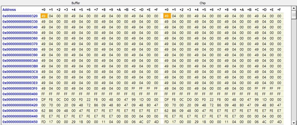

I programmed the hex file (address 0x40D write 0x7F), read back and found that address after  0x400 can not be read correctly.
But programming the same hex file (changing address 0x40D to write 0xFF or 0xDF) can be read correctly,
Gary

gary_yang
We are programmer manufacturer.
Currently encountered problems in the development of FS32K144 programming process,that is the picture of our software and we used J-Link in debug and verify.
