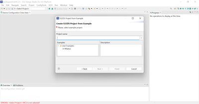

hemanths
Hello Friends,
I have recently installed the S32DS version 3.5. But I can't find any example project in the design studio. Can somebody help me how to access these example projects? I have attached the screenshot of the pop-up when I select the project from the example option.
Thanks in advance!

lukaszadrapa
Hi Hemanth,
you need to install RTD package first. Please follow the steps in this guide:
https://www.nxp.com/document/guide/getting-started-with-the-real-time-drivers-rtd:GS-AUTOMOTIVE-RTD
Lukas

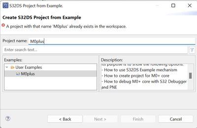

hemanths
Hi Bruno,
I followed the steps you mentioned. But still, I can't find the example projects. I have attached screenshots of the pop-up window.
Thanks and Regards
Hemanth

lukaszadrapa
Hi Hemanth,
Lukas
