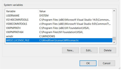

It seems like Diab toolchain (dcc.exe compiler) cannot find a valid license.
Could you possibly try to add environment variable "WRSD_License_File" that contains path to the .lic  file
Hope it helps.
Stan

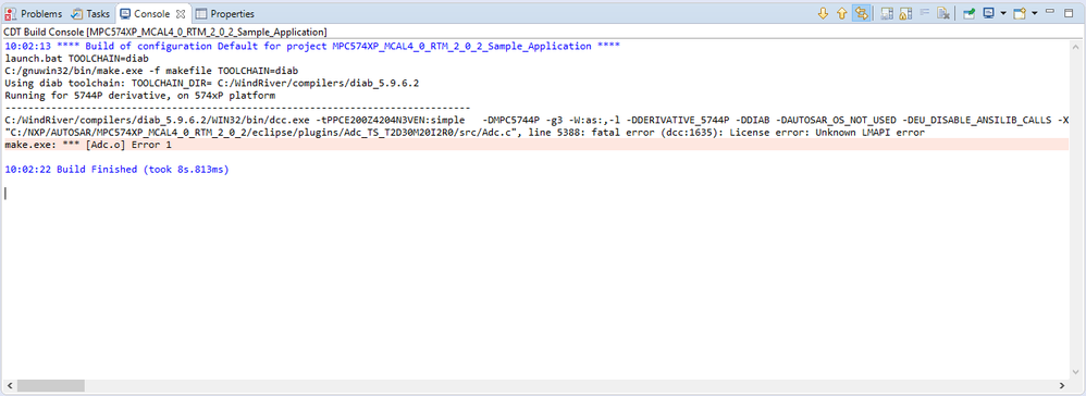

Thanks for your response Jiri. I fixed that and now S32 begins building. But now i am getting the following error message. The error message says that it is a license error but i am sure i installed the diab license correctly. Is there any other settting or  parameter change that needs to be done?
10:02:13 **** Build of configuration Default for project MPC574XP_MCAL4_0_RTM_2_0_2_Sample_Application ****
launch.bat TOOLCHAIN=diab
C:/gnuwin32/bin/make.exe -f makefile TOOLCHAIN=diab
Using diab toolchain: TOOLCHAIN_DIR= C:/WindRiver/compilers/diab_5.9.6.2
Running for 5744P derivative, on 574xP platform
C:/WindRiver/compilers/diab_5.9.6.2/WIN32/bin/dcc.exe -tPPCE200Z4204N3VEN:simple -DMPC5744P -g3 -W:as:,-l -DDERIVATIVE_5744P -DDIAB -DAUTOSAR_OS_NOT_USED -DEU_DISABLE_ANSILIB_CALLS -Xdialect-ansi -XO -Xsize-opt -Xsmall-data=0 -Xno-common -Wa,-Xisa-vle -Xdebug-dwarf2 -Xdebug-local-all -Xdebug-local-cie -Xdebug-struct-all -Xforce-declarations -Xmacro-undefined-warn -ee1481 -Xnested-interrupts -Xaddr-sconst=0x11 -Xaddr-sdata=0x11 -Xlink-time-lint -DMCAL_CER_VALIDATION -DFILE_BASENAME=Adc -c C:/NXP/AUTOSAR/MPC574XP_MCAL4_0_RTM_2_0_2/eclipse/plugins/Adc_TS_T2D30M20I2R0/src/Adc.c -I./cfg/include -I./include -IC:/NXP/AUTOSAR/MPC574XP_MCAL4_0_RTM_2_0_2/eclipse/plugins/Mcu_TS_T2D30M20I2R0/include -IC:/NXP/AUTOSAR/MPC574XP_MCAL4_0_RTM_2_0_2/eclipse/plugins/Adc_TS_T2D30M20I2R0/include -IC:/NXP/AUTOSAR/MPC574XP_MCAL4_0_RTM_2_0_2/eclipse/plugins/Base_TS_T2D30M20I2R0/include -IC:/NXP/AUTOSAR/MPC574XP_MCAL4_0_RTM_2_0_2/eclipse/plugins/Can_TS_T2D30M20I2R0/include -IC:/NXP/AUTOSAR/MPC574XP_MCAL4_0_RTM_2_0_2/eclipse/plugins/CanIf_TS_T2D30M20I2R0/include -IC:/NXP/AUTOSAR/MPC574XP_MCAL4_0_RTM_2_0_2/eclipse/plugins/Det_TS_T2D30M20I2R0/include -IC:/NXP/AUTOSAR/MPC574XP_MCAL4_0_RTM_2_0_2/eclipse/plugins/Dem_TS_T2D30M20I2R0/include -IC:/NXP/AUTOSAR/MPC574XP_MCAL4_0_RTM_2_0_2/eclipse/plugins/Dio_TS_T2D30M20I2R0/include -IC:/NXP/AUTOSAR/MPC574XP_MCAL4_0_RTM_2_0_2/eclipse/plugins/EcuM_TS_T2D30M20I2R0/include -IC:/NXP/AUTOSAR/MPC574XP_MCAL4_0_RTM_2_0_2/eclipse/plugins/Fee_TS_T2D30M20I2R0/include -IC:/NXP/AUTOSAR/MPC574XP_MCAL4_0_RTM_2_0_2/eclipse/plugins/Fls_TS_T2D30M20I2R0/include -IC:/NXP/AUTOSAR/MPC574XP_MCAL4_0_RTM_2_0_2/eclipse/plugins/Gpt_TS_T2D30M20I2R0/include -IC:/NXP/AUTOSAR/MPC574XP_MCAL4_0_RTM_2_0_2/eclipse/plugins/Icu_TS_T2D30M20I2R0/include -IC:/NXP/AUTOSAR/MPC574XP_MCAL4_0_RTM_2_0_2/eclipse/plugins/Lin_TS_T2D30M20I2R0/include -IC:/NXP/AUTOSAR/MPC574XP_MCAL4_0_RTM_2_0_2/eclipse/plugins/LinIf_TS_T2D30M20I2R0/include -IC:/NXP/AUTOSAR/MPC574XP_MCAL4_0_RTM_2_0_2/eclipse/plugins/Mcl_TS_T2D30M20I2R0/include -IC:/NXP/AUTOSAR/MPC574XP_MCAL4_0_RTM_2_0_2/eclipse/plugins/Mcu_TS_T2D30M20I2R0/include -IC:/NXP/AUTOSAR/MPC574XP_MCAL4_0_RTM_2_0_2/eclipse/plugins/MemIf_TS_T2D30M20I2R0/include -IC:/NXP/AUTOSAR/MPC574XP_MCAL4_0_RTM_2_0_2/eclipse/plugins/Port_TS_T2D30M20I2R0/include -IC:/NXP/AUTOSAR/MPC574XP_MCAL4_0_RTM_2_0_2/eclipse/plugins/Pwm_TS_T2D30M20I2R0/include -IC:/NXP/AUTOSAR/MPC574XP_MCAL4_0_RTM_2_0_2/eclipse/plugins/Rte_TS_T2D30M20I2R0/include -IC:/NXP/AUTOSAR/MPC574XP_MCAL4_0_RTM_2_0_2/eclipse/plugins/Spi_TS_T2D30M20I2R0/include -IC:/NXP/AUTOSAR/MPC574XP_MCAL4_0_RTM_2_0_2/eclipse/plugins/Wdg_TS_T2D30M20I2R0/include -IC:/NXP/AUTOSAR/MPC574XP_MCAL4_0_RTM_2_0_2/eclipse/plugins/WdgIf_TS_T2D30M20I2R0/include -IC:/NXP/AUTOSAR/MPC574XP_MCAL4_0_RTM_2_0_2/eclipse/plugins/CanIf_TS_T2D30M20I2R0/include -o ./bin/Adc.o
"C:/NXP/AUTOSAR/MPC574XP_MCAL4_0_RTM_2_0_2/eclipse/plugins/Adc_TS_T2D30M20I2R0/src/Adc.c", line 5388: fatal error (dcc:1635): License error: Unknown LMAPI error
make.exe: *** [Adc.o] Error 1
10:02:22 Build Finished (took 8s.813ms)
