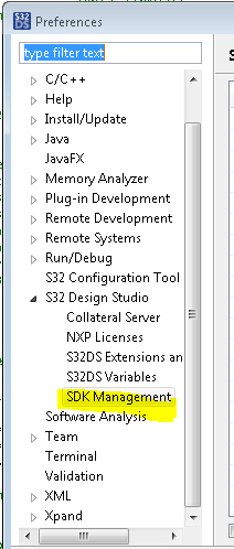

IPCF example project  cannot be imported because SDK or IPCF package is not installed correct in DS32.
Please check if S32SDK S32G EAR 0.8.0 is installed :  Windows -> Preferences -> S32 Design Studio -> SDK Management.
Check also if ipcf example is in S32SDK S32G EAR 0.8.0 example directory.
If S32SDK S32G EAR 0.8.0 is not installed, you must install it and then install again IPCF EAR 0.8.8.

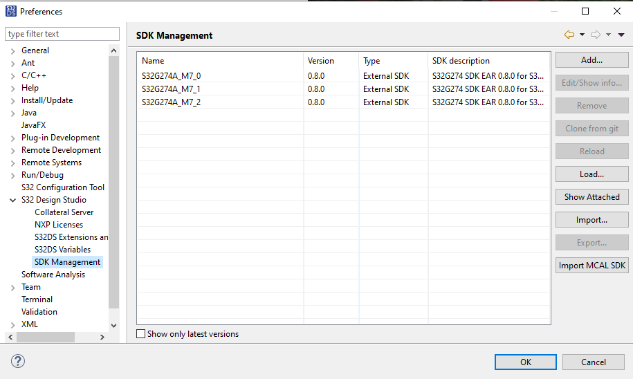

I installed S32SDK S32G EAR 0.8.0 , as seen below:
I installed IPCF EAR 0.8.8 in the location mentioned in the manual:
But still I can't see the ipcf example in my S32 Design Studio.

That installer is for AutosarOS or sample with make file.
Please search in nxp.com for S32SDK_S32G274A_IPCF_EAR_0.8.8.exe and install it.
