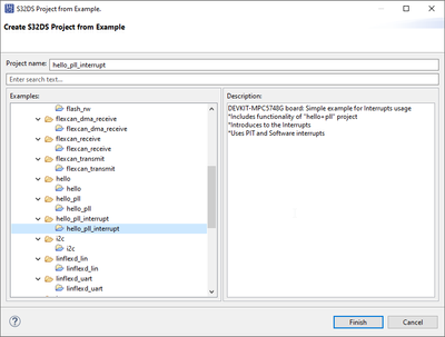

jiri_kral
good starting point is example "hello_pll_interrupt" :
Or "pit_periodic_interrupt_mpc5748g" based on SDK:

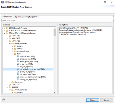

Krishnaja
Hi Jiri,
Thank you for the reply!
Actually, I want to ON a GPIO pin / LED and start a timer immediately.
In "pit_periodic_interrupt_mpc5748g" TOGGLE function is used. And in "timing_pal_mpc5748g" callBack is used, please suggest a timmer without call back.
So please suggest accordingly.
Krishnaja
2,213 Views
jiri_kral
Hi Krishnaja,

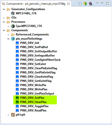

In this case - the SDK based example is the correct one  "pit_periodic_interrupt_mpc5748g". Well,  I think that right now is good time for starting with - at least - some basic documentation. With default install path you can find SDK documentation in c:\NXP\S32DS_Power_v2.1\S32DS\software\S32_SDK_S32PA_RTM_3.0.3\doc\ folder.
Anyway - you can use PINS_DRV_SetPins() or PINS_DRV_ClearPins() functions for turning LED ON or OFF.
