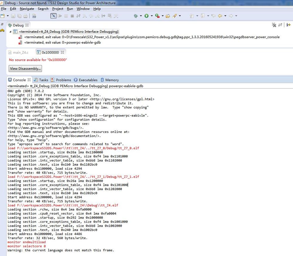

I'm working with MPC5775K in the S32DS for power v1.1. There is a strange problem when I use the PEmicro Multilink to download a project. But the project still stops in the lines" Error loading programming algorithm - load aborted" and " Error occured during Flash programming". I have removed all breakpoints.What should I do to solve this problem.Thanks.

Hi Ron,
I am not sure about this error, because I have never seen it before, but according to the error, it looks like the .pcp script, which is used for loading data to flash memory, has been modified. It is possible it is some general error, but could you please try to replace pcp files with the ones attached? Path to the files is:
C:\Freescale\S32_Power_v1.1\eclipse\plugins\com.pemicro.debug.gdbjtag.ppc_1.3.3.201605241936\win32\gdi\P&E
Please try and let me know, if it works. If not, I will try to find out another solution.

ronliu
Hi Martin,
I replace pcp files with the new ones. But the problem still exists. The console window stops in the same line.
Is it possible the false elf file could damage the MCUs?  One of my colleagues had downloaded an elf into the MCU by mistake. However the elf was generated with other IDE. Thanks.

stanish
Hi Ron,
Could you possibly indicate what is your chip mask? e.g.1N83M
Were you able to program this board before?
Do you have any other MPC577xK board available for a test?

ronliu
Hi Stanislav,
I see that the mark of the faulty chip is 1N76P.  The board had been working well before my colleague downloaded an false elf and did other incorrect operations.  I have tested other chips. They all work well. There is only one chip existed this error. Thanks.

martin_kovar
Hello Ron,
Download and install CodeWarrior
http://cache.nxp.com/lgfiles/devsuites/PowerPC/CW55xx_v2_10_SE.exe
Download this patch and update the CodeWarrior according to Readme.txt file
http://www.pemicro.com/faqs/faq_view.cfm?id=211
Run cw_progppcnexus.exe and click connect.
After that, window with choosing algorithm appears. Choose Freescale_MPC5775K1x32x1000k_CFlash_cut2.PCP
Click EM Erase module.
Try to download your .elf using S32 Design Studio once again.
