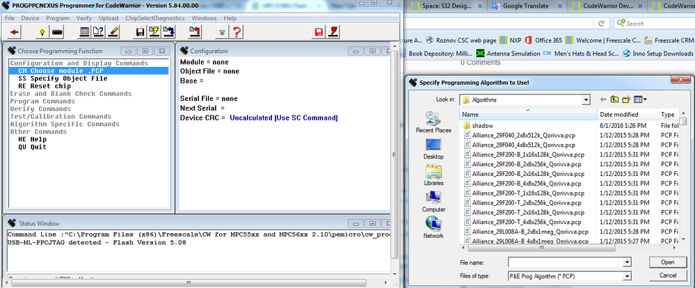

sergo86
Hello Martin,
I hope that’s OK that I use this old thread for my question.
I have a something similar problem with one Freescale SPC5602BCLQ4 (0N68H) controller.
This controller did function bevor and I did flash it many times with no problems (I use “CW for MPC55xx and MPC56xx 2.10” and Multilink Universal from PEmicro). But one time something went wrong and the flash process probably was interrupted or something else. So now I can’t flash this one controller anymore and the application doesn’t work. This is what I get:
I tried the procedure that you described:
  • downloading the patch for PEmicro, install it
  • run cw_progppcnexus.exe
  • Choose the algorithm..
I choose different algorithms (Freescale_MPC5602B_1x32x16k_DFlash.PCP, Freescale_MPC5602B_1x32x64k_CFlash.PCP, freescale_mpc5602b_cflash_dflash.PCP and some others). But none of it works, I always get an error message as in the screenshot:Flash_defect.PNG
Is there something else I could do to bring the controller to the initial state, so that it functions again?
I would appreciate some help from somebody.
Thank you,
Serge

ronliu
Martin,
It shows a window when I try to choose a algorithm. The cw_progppcnexus.exe is able to connect the chip. But it goes wrong when I select the PPC file. I don't understand what is Division by zero ? What should I do more ? Thanks
Ron
8,230件の閲覧回数
martin_kovar
Hello Ron,
I have never seen this error yet. It seems like some internal application error. Did you try to choose Freescale_MPC5775K1x32x1000k_CFlash alghoritm instead of cut2?
Did you try to choose different algorithm (only choose, do not execute any other command), for example for MPC5744P? Did the error occur too?
Have you correctly update PEMicro folder in CodeWarrior installation folder? Maybe it will be better to try reinstall CodeWarrior and copy the patch again. Maybe some error occurred during patch copying.
