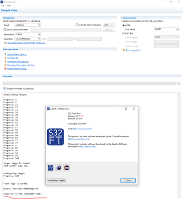

I am using the S32G-VNP-RDB2.
I have installed S32Flashtool2.17 and am trying to update uboot using this Flash Tool.
When using the Flash Tool, the test connection passes, but I encounter an error when clicking
'Upload target and algorithm to hardware'.
Progress: 100
Flash algo is loaded.
Error: Algorithm initialization is failed.
I would like to know the cause and solution for this issue.

Thanks for your feedback.
On regards of the eMMC algorithm failing, seems to be a HW misconfiguration. This seems to be related to the following community thread, in which a solution was already provided:
Solved: S32 Flash Tool failure to establish communication with device - NXP Community
Might be of use.
As for S32FlashTool v2.17, we have no problem on loading the eMMC algorithm once the HW is configured correctly:

dylee
Thanks to the image you shared, I achieved the same results with the same settings.
I noticed the difference in settings between us through the screenshot you shared. I set the Algorithm to EMMC, while you set it to MX25UM51245G. I am not very familiar with Algorithms. Can you explain the various algorithms available, including MX25UM51245G? Or could you share related documentation?

Daniel-Aguirre
In general, the algorithm refers to a specific Flash Memory. In the case of EMMC, this is a JEDEC standard, for which all eMMC memories should implement the same algorithm.
On regards of NOR Flash devices, they do not have a strict JEDEC standard, for which a specific algorithm needs to be used depending on the specific memory P/N. Under the RDB2, the NOR Flash memory P/N is the one we selected under the algorithm (MX25UM51245G), that is why we see no problem when loading the algorithm.

dylee
Thank you for your prompt feedback. I have an additional question regarding the information you provided in your response.
As you mentioned, I have confirmed that data is being stored correctly through the Nor Flash algorithm. However, when I select the eMMC model in the UI Tool I am using, it does not seem to function smoothly. I was wondering if you have tested the eMMC model at your end and if it works properly when selected. I would appreciate your insights on any potential issues related to algorithms or drivers specific to eMMC.
Furthermore, I would be grateful if you could provide detailed guidance on the steps I need to follow to perform a Flash Download on eMMC. It would be very helpful if you could explain the specific procedure, including any necessary files, tools, and settings.
