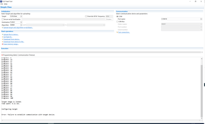

  Then I use the flash tool to burn binary files into EMMC:
 It's always failure to establish communication with target device.
