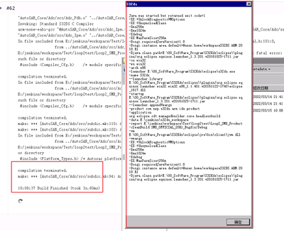

I using S32 Design Studio for Vision 2018.R1.  build my project using the command line and my project has an error.
After the build is finished, only the error message is displayed as below, but the ERRORLEVEL variable is not changed
Does this issue come from eclipse not supporting or is the version of JDK incorrect?
Error message:
17:11:19 Build Finished (took 22s.304ms)
Eclipsec:
Java was started but returned exit code=1

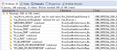

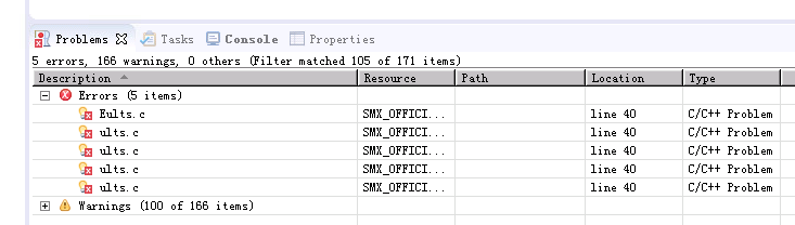

      6). after the building finished, we can see that there are some errors in the Problem view of S32 Design Studio, and these errors has no relation with the project, and I can not find these files that errors indicating in the system local drives.

                         4).  some erros appear in  the Problem view of S32 Design Studio
                         5) and ""Java was started but returned exit code = 1" dialog" pops up when build using command line.

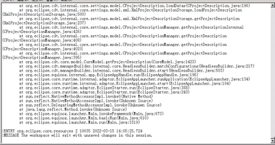

For some reason, I can't attach the log here. but the S32DS workspace log file under .metadata always has a message like:

for a totally idea project, when compiled on the new nev, there is no building error( means error displays in s32 design studio window's Problem view),  but  on the old env, there is some errors displays which indicates some .h not found, but indeed these .h files exists.

redlin6688
Hi, I has encounter this issue recently, and have no idea about solving it.
I try to use S32DS for ARM v2018.R1 to buid a project.
Start from the client UI, it is OK

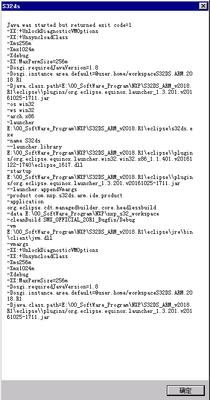

but once I start it from the command line interface( call a bat from jenkins), when the build process finished, it will definitely pop up a dialog window to say that Java was started but returned exit code=1(see attached picture).
