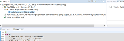

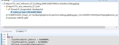

      The processor I use is MPC5777C, the debuger I use is Multilink_Universal_FX, and the IDE I use is S32 Design Studio for Power Architecture Version 2.1.I created the project to be able to debug in RAM and flash.
      But I can't download the generated .elf file to flash using the flash from file tool.Attached is the .elf file generated by the project.The compilation information of the console is as follows:

It's not clear what the issue is here. The log you provided shows a successful flashing event from using the Flash from File utility. The images you shared are displaying the result of successfully starting a debug session. Each of these is from separate, unrelated, actions. Are you trying to flash or debug? Both appear to be working well.
Perhaps there is some misunderstanding?
