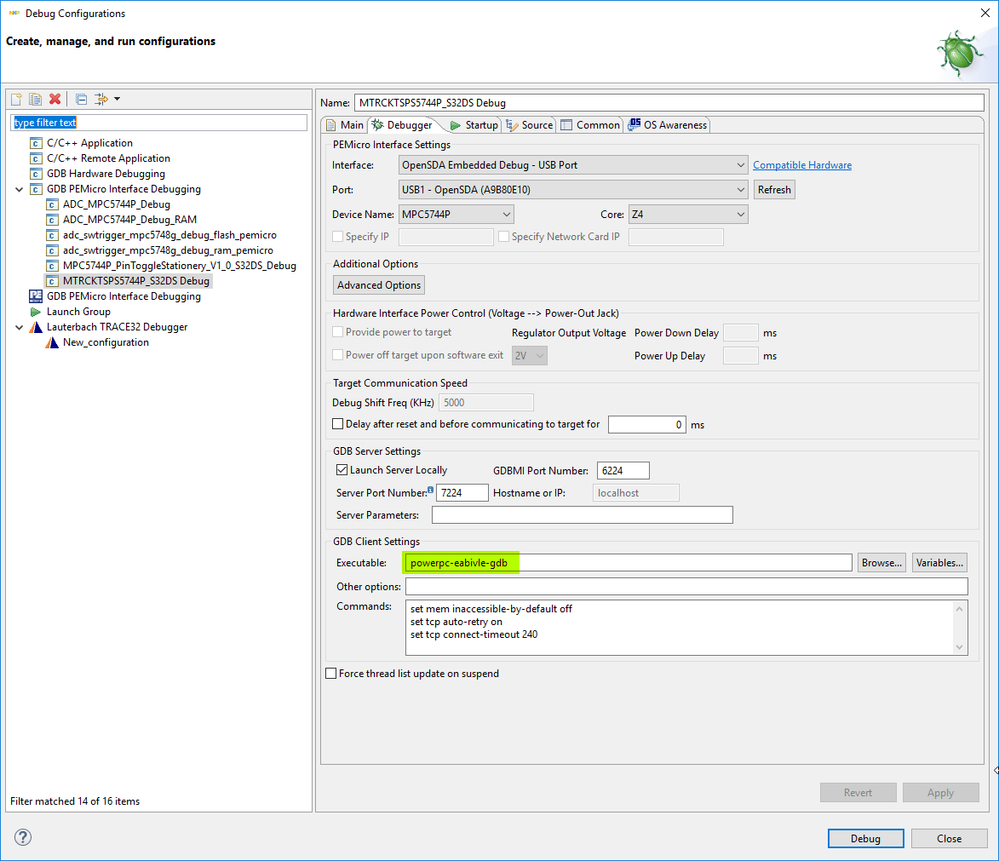

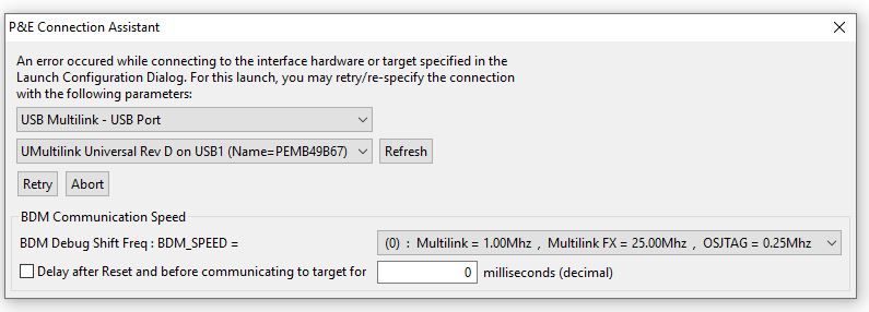

When I debug the SCH-27513 MPC5744 with S32DS POWER it has the errors:
how could I solve it?

From your screenshot it looks that you are using incorrect gdb executable. Please check your GDB settings:
Jiri

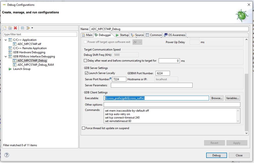

chinna_polukant
I am also having same configuration. Still, I am facing the same issure.config.JPG

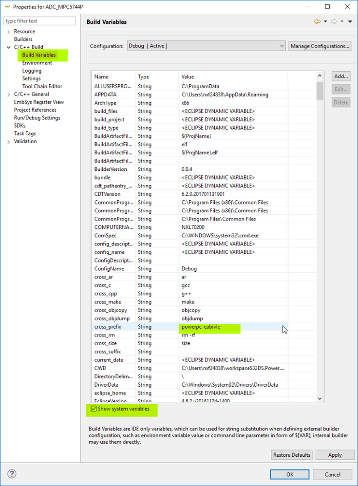

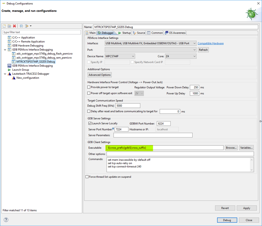

jiri_kral
make sure, that ${cross_prefix} contains correct value in project properties:
Or you can write it manually into debug configurations or manually browse the executable:
Also re-install may help to setup env variables correctly.
