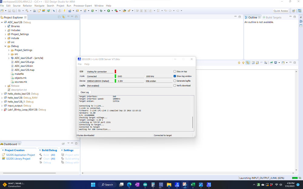

Using LPC LINK2 (jLINK) and Segger J-Flash Lite I was able to program FRDM-KEAZ128Q80
Screenshot 2023-01-12 161902.pngScreenshot 2023-01-12 161902.pngScreenshot 2023-01-12 173653.pngScreenshot 2023-01-12 173653.png
But S32DS ARM2.2 IDE is giving me the Error in services launch sequence Starting J-Link GDB Server Timed out
I am using windows 11..please help as I want to debug

Hello @shamika17,
How are you connecting the LPC-Link2 to the FRDM-KEAZ128Q80? Could you share a photo of the connection?
It is much easier to use the P&E OpenSDA connection for debug. Just connect USB cable to both your PC and the board.
Mike
