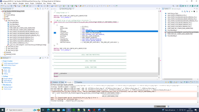

Hello NXP support team,
I am trying to configure the S32K3XX RTD SPI driver for the 172 pin package using S32DS 3.4 update 3. But every time I add a new new pin/signal routing in the pins tool and build the project, I am getting an error as shown. Could you please help me with this?
NUM_OF_CONFIGURED_PINS0' undeclared here (not in a function): this is the error that pops up. Please do share your thoughts.

Hi @GopikaFaraday
The RTD controller can help users to use Autosar and Non-Autosar to develop their applications. For some complex controllers, users can also combine these two methods.
The example you are using is done in MCAL to implement the port function, and you don't need to configure Pins.
Take a look at Siul2_Port_Ip_Example_S32k344.
