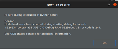

My team & I have been trying to use the debug probe with the S32V234 SBC. We have the S32 Design Studio installed on a Windows machine.
When we try to start a debug session for the example project hello_world_s32v234 via the debug configurations "C/C++ Remote Application", we get the error "Could not start gdbserver on the remote host.". If we try to run the command manually on the board, we get the error "Process /home/root/downloads/hello_world_s32v234.elf created; pid = 1054 ../../../gdb-8.0.1/gdb/gdbserver/regcache.c:44: A problem internal to GDBserver has been detected. regcache* get_thread_regcache(thread_info*, int): Assertion `proc->tdesc != NULL' failed. logout".
While if we try to start a debug session for a new empty application project that we've created (S32V234 Cortex-A53 Linux project) via the debug configurations "C/C++ Remote Application", the session starts. But then when we try to start to debug via the debug configuration "S32 Debugger", we get the error "Failure during execution of python script. Reason: Flash error has occurred during starting debug for launch 'new_a53_linux Debug'. Error code is 500.".

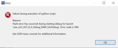

ahmedgheith
Hi Mike,
Just for clarification, when I try to run a debug session through the Windows machine, I get a different error code number.
Ahmed

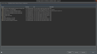

12,570 Views
ahmedgheith

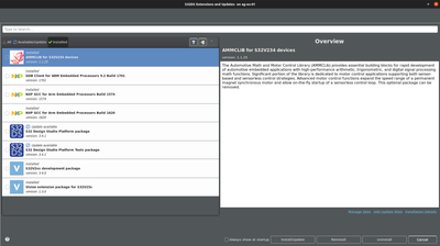

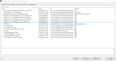

Hi Mike,
Here's a screenshot from the Installation Details menu
Screenshot from 2022-06-14 10-11-20.pngScreenshot from 2022-06-14 10-11-20.png
And another one from the Extensions and Updates menu
Screenshot from 2022-06-14 10-13-39.pngScreenshot from 2022-06-14 10-13-39.png

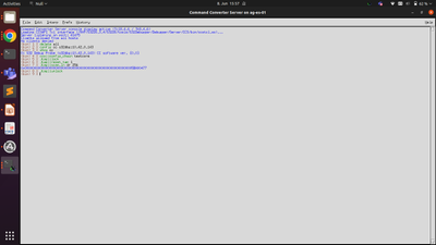

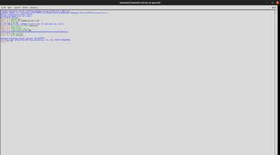

Regarding running the CCS commands again; I restarted the board and the debug probe, then I ran the commands and here's a screenshot of the CCS console
Screenshot from 2022-06-14 11-07-00.pngScreenshot from 2022-06-14 11-07-00.png
hen I closed the CCS console (note: if I don't close the CCS console first, S32DS will not be able to connect to the debug probe) and I tried to run a new debug session, and here's the message I got and the output of the console
Screenshot from 2022-06-14 11-12-26.pngScreenshot from 2022-06-14 11-12-26.png

Ahmed
13,532 Views
mikedoidge
For the first issue, the description appears to be very similar to the recently reported issue in another posting to the community, perhaps the problem is the same?
https://community.nxp.com/t5/S32-Design-Studio/error-launching-gdbserver-on-s32V234-with-linux-bsp23...
For the second issue, the problems may be caused by Linux executing on the A53 core on the target. Currently, the S32 Debugger does not support debugging of a core that has Linux executing. So this means, you can debug the A53 core, but the A53 image must be loaded via the S32 Debugger and not by Linux. You should not have Linux running on the target. In addition, if you have A53 executing an application running on Linux, then the S32 Debugger could still be used to debug another core, such as M7, by using the attach.py initialization script. The issue only occurs when trying to use S32 Debugger on the A53 while Linux is executing.
Hope that helps,
Mike
13,230 Views
ahmedgheith
Hello Mr. Doidge,
Thanks for your reply. It helped me understand a couple of things, but still it raises multiple questions from my side.
1- How to load the A53 image via the S32 Debugger?
2- I followed this playlist presented by you, https://www.nxp.com/design/training/getting-started-with-s32-design-studio-ide:TIP-S32DS-Extension-P..., and during videos 5 and 6 you explained how to setup and debug ISP and APEX projects using the S32 Debugger and the S32 Debug Probe. And you said explicitly that Linux BSP must be running on the board, and you referred to a document on how to run the OS on the board. I followed this document as well, and it didn't mention anything regarding loading the A53 image via the S32 Debugger. And the example projects you are using in the videos are running on the A53. So how is this possible when you are saying now that "the issue occurs when trying to use S32 Debugger on the A53 while Linux is executing."?
I hope you can help me understand, and get started properly with this hardware.
