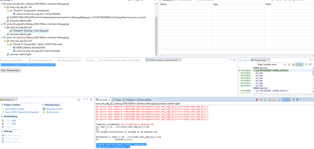

Debug problem:No source available for "IVOR1_Vector() at 0x13a1010"
1,674 Views
timwang
When i debug the sub-project Z2_3,it shown this message.
What's wrong with my project or should i do some other configuration?
1,531 Views
jiri_kral
it looks like that the core 3 ends in unhandled exception for some reason. Are you able locate which instruction invoke IVOR1 ? (try to step by step debug on Z2_3 core).
