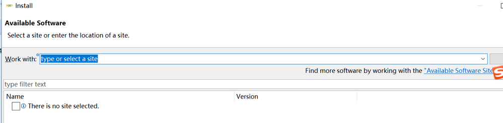

  I have successfully installed S32ds for 1.2,But my computer can not connect to the network.I can not install ProcessorExpert  as shown in the following figure.Can you tell me how to install ProcessorExpertin in any other way, or have a PE executable I can install locally?pastedImage_3.png

you can get offline update 3 from this link (login required):
S32DS Power v1.2 Update 3
More info is in this doc - https://community.nxp.com/docs/DOC-335362
Jiri
