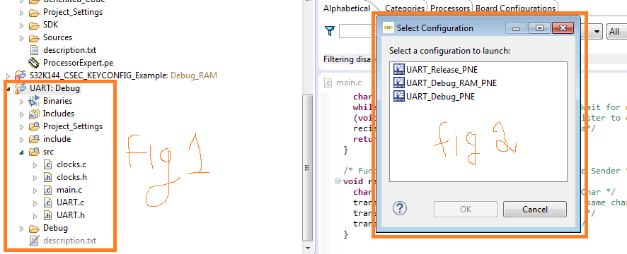

I have a simple question, please don't mind.
I could build the project in Fig 1.
When I try to debug, fig 2 screen pops up. Please explain me 3 different options available in fig 2. Also which one should I select for debugging ?

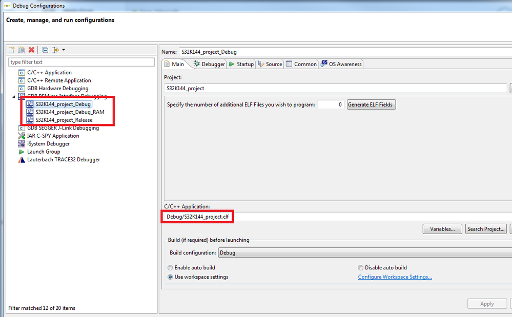

Basically If you create a new project for e.g. S32K144 there are 3 different build configurations available.
  • Debug_Flash
  • Debug_RAM
  • Release
Each configuration may use different linker file to place the code into - RAM /Flash
or different build tools setup (no optimization vs. full optimization) - Debug/Release
For more details see:What is the difference between Debug RAM and Debug Flash?
The output folder (where the executable/binary/object/dependency/make files are placed into) changes based on selected Build Configuration.
e.g. in case  "Debug" build configuration "Debug" sub-folder is created within the project folder.
Now each build configuration has it's own dedicated debug configuration since each build configuration uses a different output file. The debug configurations can be also differently customized e.g. debug version vs. release one.
Anyway if your active build configuration is "Debug" you should use the debug configuration with the same prefix name e.g. S32K144_project_Debug
back to your screenshots: The project manager on Figure 1 shows that your active build configuration is "Debug" so you should use "UART_Debug_PNE" in figure 2.
