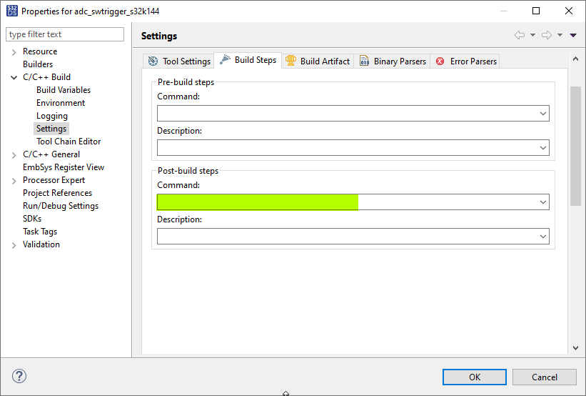

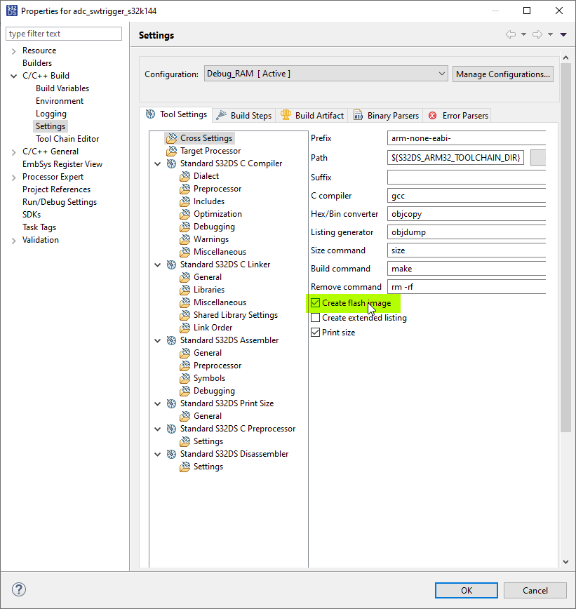

unfortunately I don't have installed DIAB on my machine, but with DIAB toolchain it should be similar. Right click on project name -> Properties -> Settings and choose Cross Settings:
Then press Apply button. You will see new section -Flash Image  in settings:
If there is no such option - you may add a post build step with command:
mb-objcopy -O srec your_elf_file.elf your_srec_file.srec
Jiri

Thanks, but the configuration window is different from the GNU configuration window.
I have also tried the command you say and it gives me an error.
