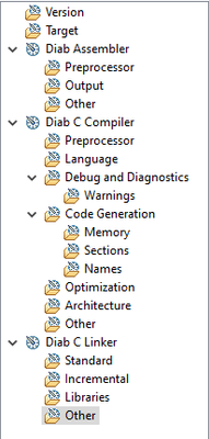

I'm usig the diab compiler and I can't generate the binary of my program. Someone knows how I can generate the binary?

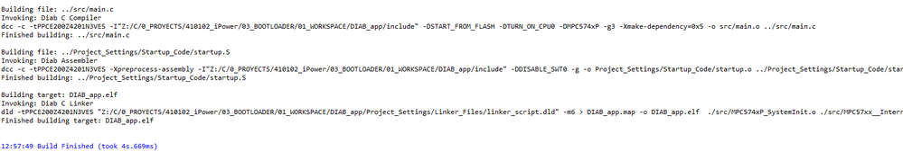

Ekaitz
I want to generate .bin or .hex or .mot from the .elf.
At the begining is compile correctly.
But it apeared two errors in the problems window.

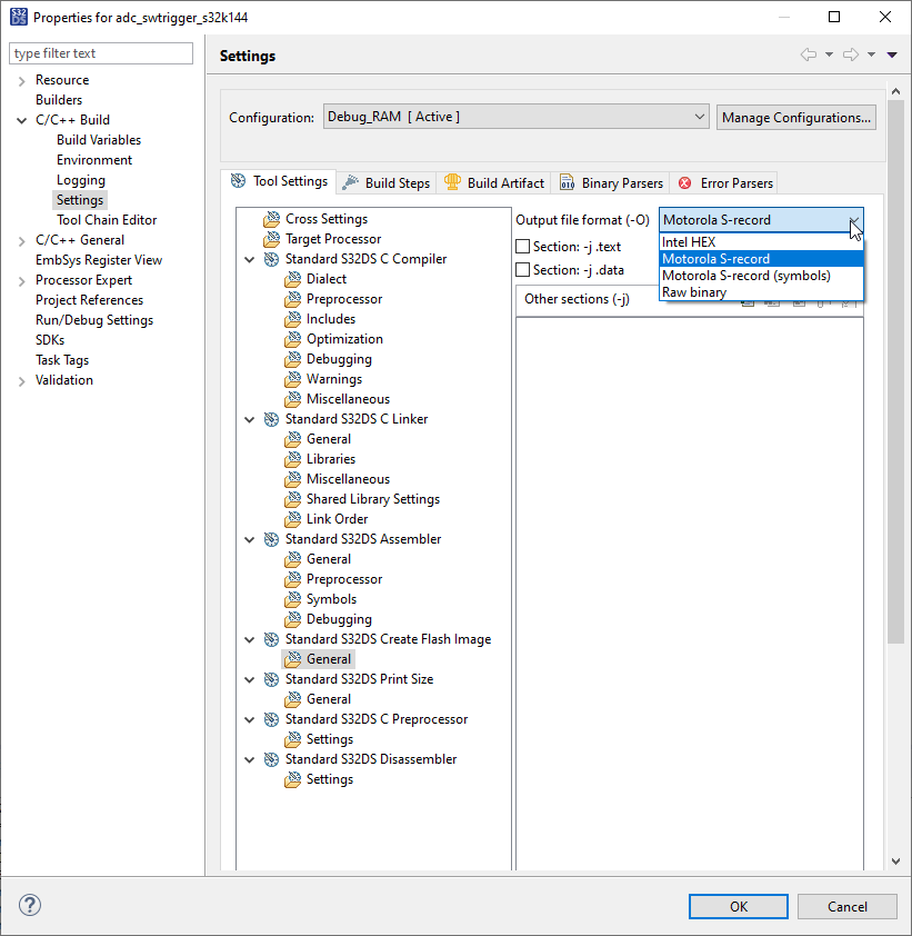

unfortunately I don't have installed DIAB on my machine, but with DIAB toolchain it should be similar. Right click on project name -> Properties -> Settings and choose Cross Settings:
Then press Apply button. You will see new section -Flash Image  in settings:

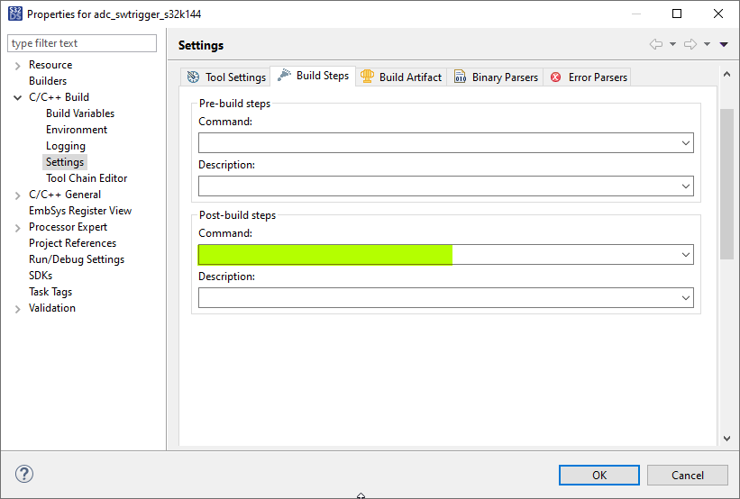

If there is no such option - you may add a post build step with command:
mb-objcopy -O srec your_elf_file.elf your_srec_file.srec

Thanks, but the configuration window is different from the GNU configuration window.
I have also tried the command you say and it gives me an error.
