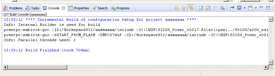

can you please share your output from build console?
Jiri
10,435 Views
yashvardhan
Thanks Jiri Kral for helping my console looks like something.

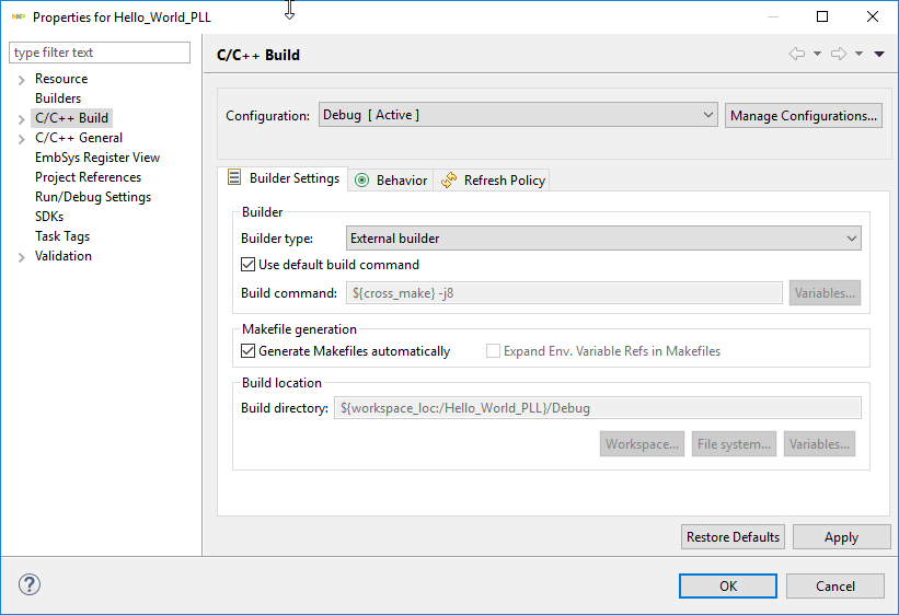

You can try to use external builder. The internal one is not able link object into elf file.

jiri_kral
The console output can't be same with external builder. Before build - clean project (right click on project name -> clean ), double check if External builder is set (don't forget press apply button). If build fail - please attach console output for external builder.

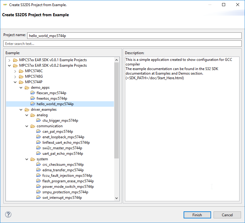

It looks like that your project is empty - without any source code (or makefile is broken for some reason). Please try to create new project: File -> New -> New S32DS Project
Choose part which you are interested in:
Other way is start with some example project with SDK and processor expert (or Example project without SDK):
File -> New -> Project from Example

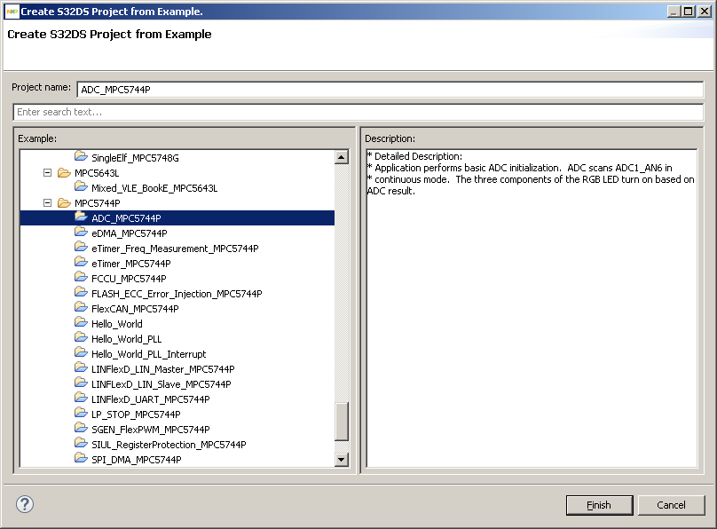

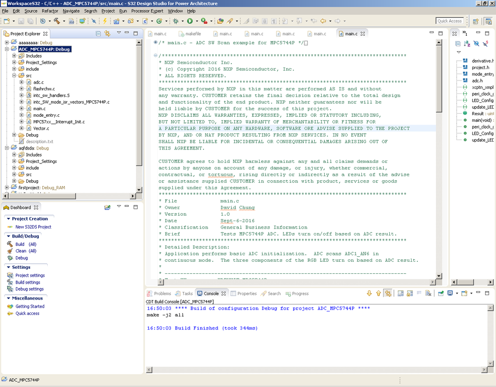

yashvardhan
dear did the same but all I am getting is this.
10,436 Views
jiri_kral
Um - looks strange. Well - in this case I'll recommend to uninstall your S32DS - and try to install S32DS again.
