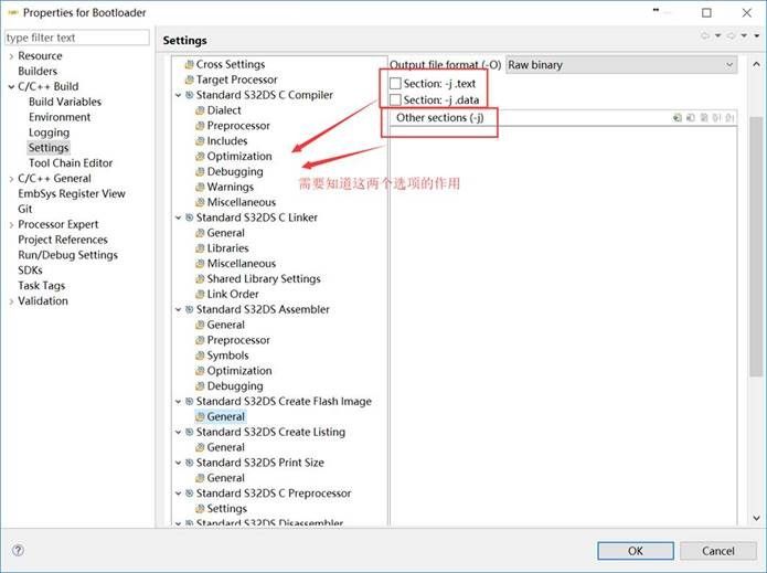

I have some question about S32KDS as follow,
1, Could you help to explain the effect of the red frame(Section j.text””Section j .data” “Other Sections

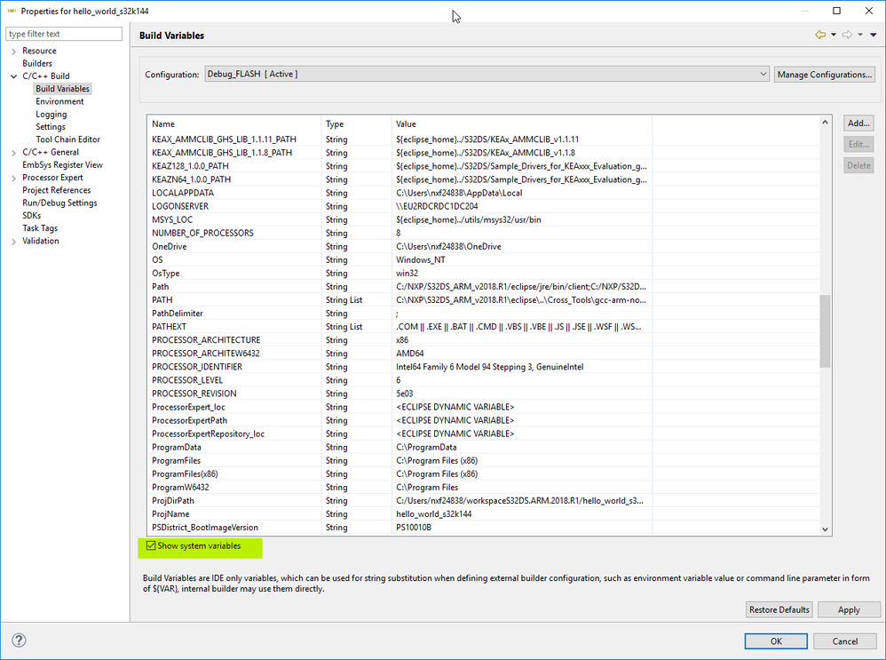

2,where had it come from about "${ProjDirPath}" ,I do not find it in the S32KDS. about this type macros,could you help to list it ,explain the default vaule and definition rules

you can chose any particular section to be part of flash image (the standard one like .data or .text) - or you can add your custom sections. If no section is selected - all sections are part of flash image.
Build  variables are in C/C++ Build -> Build Variables. Each project is using general variable name (like $ProjDirPath) - but each project has it's own value of that variable:
