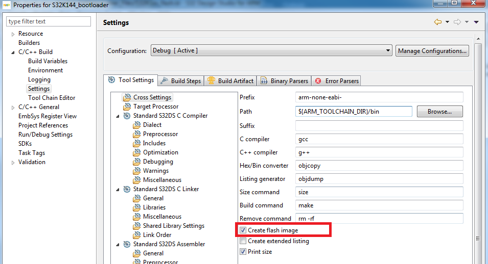

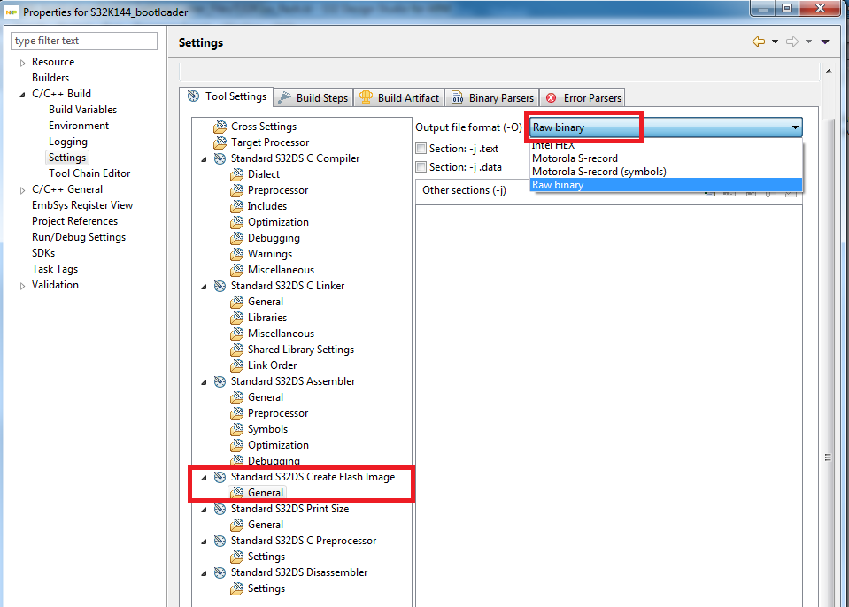

2) Enable creation of flash image for the bootloader project to generate binary image (.bin)
and select binary file format:

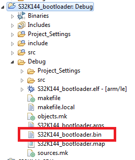

3) Build the bootloader project and you should see the bootloader .bin file in the project output directory:
Now let's switch to application project which will link the bootloader bin file.

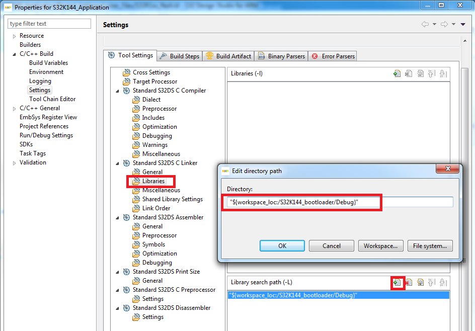

3)  add the path to bootloader.bin file into the application project settings as a library search path:
4) Build the application project and check the generated .map file to confirm the bootloader.bin has been included:
.my_boot 0x00000000 0x594
 S32K144_bootloader.bin(.data)
 .data 0x00000000 0x594 C:/workARM_2.0/S32K144_bootloader/Debug\S32K144_bootloader.bin
 0x00000000 _binary_C__workARM_2_0_S32K144_bootloader_Debug_S32K144_bootloader_bin_start
 0x00000594 _binary_C__workARM_2_0_S32K144_bootloader_Debug_S32K144_bootloader_bin_end
Now the application elf/binary image contains both application and bootloader.

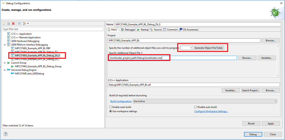

Another approach to "merge"  bootloader and application using debugger. PEMicro debug configuration allows loading of multiple .elf/srec files  (they call it additional object file).
First of all enable creation of srecord image for the bootloader project:
https://community.nxp.com/message/631160#comment-631306
then enter generated srec as the additional Object file for the boot core debug configuration:
When you launch the group or debug this configuration - bootloader srec will be loaded with the elf file.
