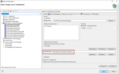

I'm not sure if this is the option you are looking for, but you can also select an output file from "Debug Configurations > Standard Input and Output"

- unfortunately, I believe that this still relies on the use of the stdio library functions that as per my prevous explanation I can't use in my design.
I was hoping to find debugger console command options that would re-direct the console command output to a local file.
For example, the debugger console command 'print' supports a variety of command line options to format and display program variables and memory to the console, but I cannot identify any setting to redirect that command output to a local file.
Dave

To clarify:
I have been referring to the output obtained from the IDE Debugger Console :
- not the Standard input/Output console:
Dave
