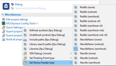

1. Make sure you use fprintf instead of FPRINTF (to avoid the macros)
2. Make sure you are using the semihosting version of the library. Either Redlib (semihost), Newlib (semihost) or NewlibNano (semihost) from the Quick Settings
7,452件の閲覧回数
caden013
Thanks for the quick response.
I should have mentioned that I used a macro to define FPRINTF as fprintf -- just to maintain the formatting like the other functions (PRINTF, GETCHAR, SCANF, etc.).
From the quick settings, I can access the "Set library/header type" tab, but all the options are grey and inaccessible. How can I go about fixing this issue?

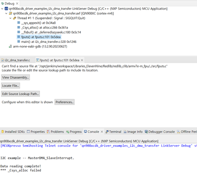

mjkimbravo
I have a similar problem of yours, my code is as below (only parts). Both fprintf and fputs don't work. The file "fromIC.txt" is made well in the "doc" folder of my SDKs. Would you please teach me how to write .csv or .txt file from MCUXpresso IDE?. My MCU is QN9080, and library is Redlib(semihost). I also attach the error message.
Please help me;;
FILE* datas;
datas = fopen("fromIC.txt", "w");
int inter = 123;
char str[] = "string ccc";
// fprintf(datas, "integer: %d", inter);
fputs(str, datas);
fclose(datas);
