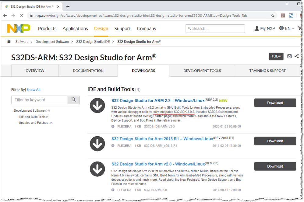

I installed S32DS for ARM 2.0 and then wanted to install patch (S32DS_ARM_v2.0_UP3_K14x_SDK_EAR_086_171208.zip). However, it always failed here and reported an error info as below.
An error occurred while collecting items to be installed
session context was:(profile=SDKProfile, phase=org.eclipse.equinox.internal.p2.engine.phases.Collect, operand=, action=).
No repository found containing: binary,com.freescale.s32ds.cross.sdk.FreeMASTER_root,1.0.0.201708101254
No repository found containing: binary,com.freescale.s32ds.cross.sdk.KEAx_AMMCLIB_root,1.0.0.201708101254
No repository found containing: binary,com.freescale.s32ds.cross.sdk.KEAx_root,1.0.0.201708101254
No repository found containing: binary,com.freescale.s32ds.cross.sdk.S32K14x_AMMCLIB_root,1.0.0.201708101254
No repository found containing: binary,com.freescale.s32ds.cross.sdk.s32k14x_0.8.4_root,1.0.0.201708101254
No repository found containing: binary,org.eclipse.platform.ide.executable.win32.win32.x86,4.6.2.M20161124-1400
I also tried to install patch (S32DS_ARM_v2018.R1_UP11.zip) on S32DS for 2018R1 but came across a similar situation, about details please refer info below.
No repository found containing: binary,com.freescale.s32ds.cross.sdk.FreeMASTER_root,1.0.0.201801242147
No repository found containing: binary,com.freescale.s32ds.cross.sdk.KEAx_AMMCLIB_1.1.11_root,1.0.0.201801242147
No repository found containing: binary,com.freescale.s32ds.cross.sdk.KEAx_AMMCLIB_root,1.0.0.201801242147
No repository found containing: binary,com.freescale.s32ds.cross.sdk.KEAx_root,1.0.0.201801242147
No repository found containing: binary,com.freescale.s32ds.cross.sdk.S32K14x_AMMCLIB_1.1.11_root,1.0.0.201801242147
No repository found containing: binary,com.freescale.s32ds.cross.sdk.S32K14x_AMMCLIB_root,1.0.0.201801242147
No repository found containing: binary,com.freescale.s32ds.cross.sdk.S32V234_AMMCLIB_1.1.11_root,1.0.0.201801242147
No repository found containing: binary,com.freescale.s32ds.cross.sdk.s32k14x_0.8.6_root,1.0.0.201803221112
No repository found containing: binary,com.nxp.s32ds.brc.arm.earmv7.win32.feature_root,6.3.0.201712081638
No repository found containing: binary,org.eclipse.platform.ide.executable.win32.win32.x86,4.6.3.M20170301-0400
I also re-installed S32DS but it made no sense …
Does anyone know how to solve this problem … Thanks in advance.

Hi gang,
Please try to install the latest S32 Design Studio for ARM 2.2 – Windows/Linux(REV 2.2).
Robin
