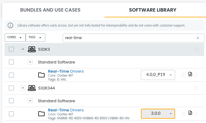

jleveque
Where can I find "S32K3xx RTD v5.0.0"? I am developing for a S32K344 MCU, and if I look at what's available for the S32k344, the latest RTD is v3.0.0. If I search for S32K3, the latest is 4.0.0_P19 (see screenshot below).

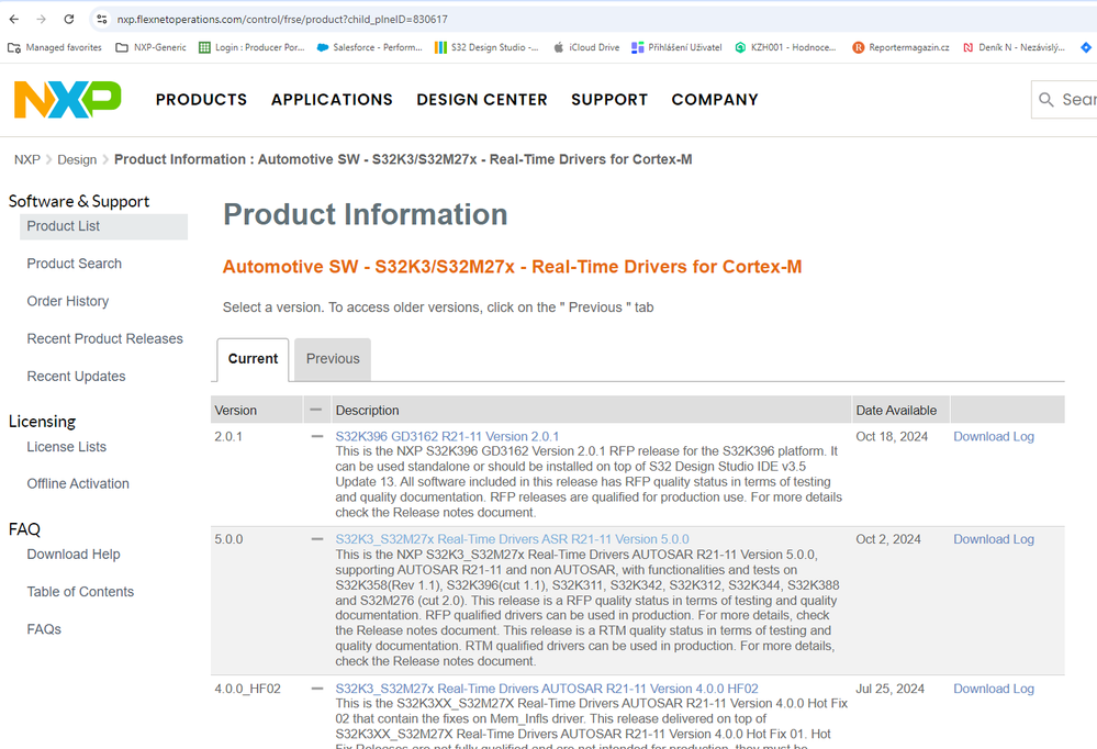

jiri_kral
you can find it as an offline package in your software account
https://www.nxp.com/mynxp/profile

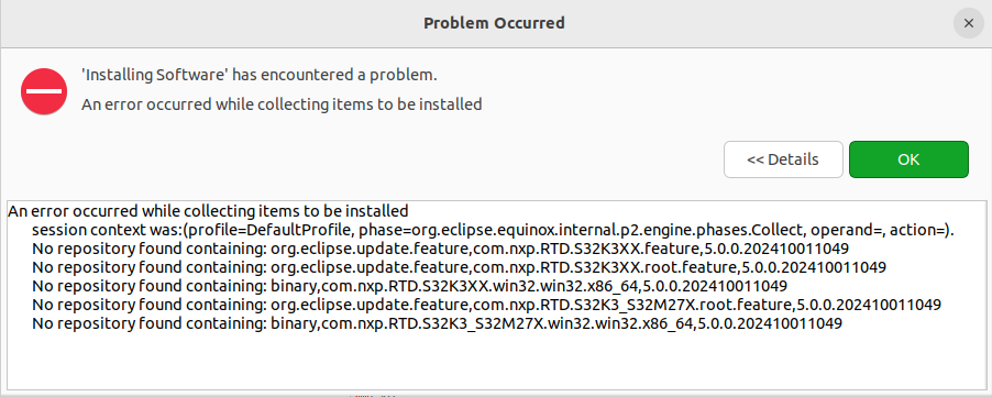

jleveque
Thank you. I downloaded SW32K3_S32M27x_RTD_R21-11_5.0.0_D2410_DesignStudio_updatesite.zip and in S32 Design Studio, I added that zip file using the "Add Update Sites" option. However, I do not see any extensions show up in the "Available/Update" list. What do I need to do to install this?

jleveque
I found this post where you informed someone else that
RTD is not supported on Linux - but can be installed as an offline update package. The package can be download as a .zip archive from your NXP Downloads account.
You can install it via Help -> Install New Software
So I tried this method, and I am greeted with the following error:
5,696 Views
jiri_kral
sorry, I missed that you are installing it on Ubuntu. Unfortunately RTD is not supported on Ubuntu host.
