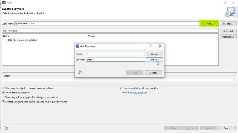

jiri_kral
So, it is possible install RTD for S32K3 on Ubuntu machine from offline package via Help -> Install New Software. The main issue is, that Linux is case sensitive OS and some RTD files doesn't match filename and file definition inside the Config tool.
The effort how to fix it depends on complexity of your project. For simple one you need to fix only few rows in couple .xml files. If the project will be more complex - it may be dozens and dozens files and rows.
You may also met other issues about we aren't aware (the case sensitivity is known issue) - and there are no resources to fix it on our side. RTD is not tested on Linux and is not officially supported on Linux.

jiri_kral
Hi Ashok,
as I said - RTD is not supported on Linux - but can be installed as an offline update package. The package can be download as a .zip archive from your NXP Downloads account.
You can install it via Help -> Install New Software
