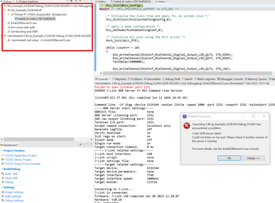

1. I am working on the C40_Ip example driver. When I go to debug, it does not enter debug mode.
Hardware: S32K344 (MR-CANHUBK344)
IDE : S32DS 3.5.14
Debug TOOL: J-link (Hardware v9.0)
RTD Version: S32K3_RTD_4_0_0_D2311
Here I attached the screenshots of the console output while debugging the C40_Ip example

Hi @karmegancjk @,
Please verify that the configurations and paths of the executables are correct. You can refer the following link for guidance:
S32 Design Studio for S32 Platform V3.4/V3.5 + SEGGER J-LINK Plus
Additionally, this issue could be related to the host PC, have you tried changing the port number?
You can check if any other application is using gdb server's port. To do this you can run the following command in the Windows command line: netstat -ano
Let me know if this helps or if you need further assistance.

karmegancjk
Thanks for the update. I have verified that the debugger configurations and paths of the executables are correct.
1. The GDB server upgrade and configured the setting   as per the following link(https://community.nxp.com/t5/S32-Design-Studio-Knowledge-Base/S32-Design-Studio-for-S32-Platform-V3-...)however i am getting errors ,
those errors are
                "Failed to open listener port 2331",
                "J-link GDB server failed "
2.is there any points to consider while working on Flash memory  for Flash driver development
3. while entering debug  system stay in only  "Starting target CPU"  debugger not move on the next step.

here i attached the screenshots for your reference ,how to solve this issue.

Hi @karmegancjk ,
1.Theses error are related to each other, if you have another active debugging session on S32DS or the J-Link GDB Server application open, the system throws these errors, please verify that the port number (2331) is not already used, if so, you can change it, terminate the session in S32DS or kill the process number in the Windows Command line.
2.No special considerations are required for these RTD Example Projects, you should be able to work with these examples without problems.
3.Have you encountered this issue with another RTD example? we can't replicate the issue, but it could be related with the startup in 0x00402420.
