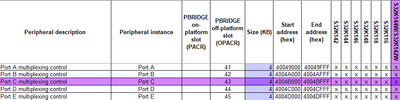

Hi @ArkAndyFraser
Did you make any modifications to the example code? According to the address 0x4004B020, the problem looks like it is in the Pin Control Register of the PORT C.
Please check the exact instructions that caused the BusFault. It can be debugged as explained in this document/example: Fault handling on S32K14x.

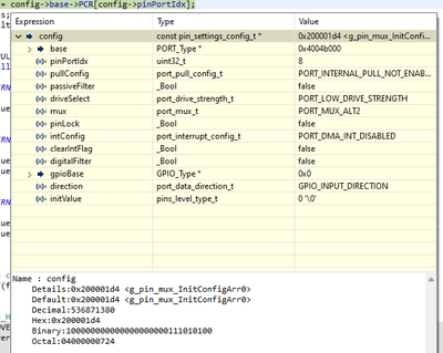

ArkAndyFraser
@VaneB
It is completely unmodified - I chose choose new project from example, built the project and then hit debug. It fails here:
void PINS_Init(const pin_settings_config_t * config)
DEV_ASSERT(config->base != NULL);
DEV_ASSERT((PORT_MUX_AS_GPIO != config->mux) || (config->gpioBase != NULL));
DEV_ASSERT(config->pinPortIdx < PORT_PCR_COUNT);
uint32_t regValue = config->base->PCR[config->pinPortIdx];  <----------------------------------
uint32_t directions;
uint32_t digitalFilters;
port_mux_t muxing;
Thanks for your help.
