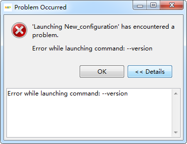

wuxiesi
Thanks for your help.I found the way to solve the problem in Help Contents,as your method.
the error may be caused by  lost the GDB Client Settings,when I add the gdb.exe path,it is gone.

wuxiesi
Thanks for your informations.I use Pemirco Multilink debug.
I have installed the lasted version v1.3,and follow your step.However,I can't find any file ending in '.srec'  in my project library.So, what should I do to creat a '.stec' file?
Also ,I try to execute the '.elf' file,and I will get a error like this:pastedImage_1.png

jiri_kral
to get srec file you need to enable it in project properties.
Right click on your project name -> properties -> C/C++ Build -> Settings
You can find srec file inside Debug/Release directory (depends on your configuration).
In which step you get the error message? During upload the elf file into MCU?
