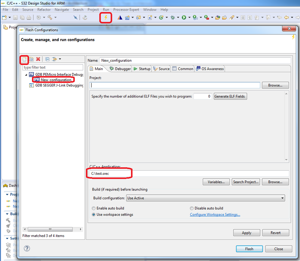

I program with S32 Design Studio for ARM v1.2. Now I want to program the ship without source file,just like the file .hex of Keil?

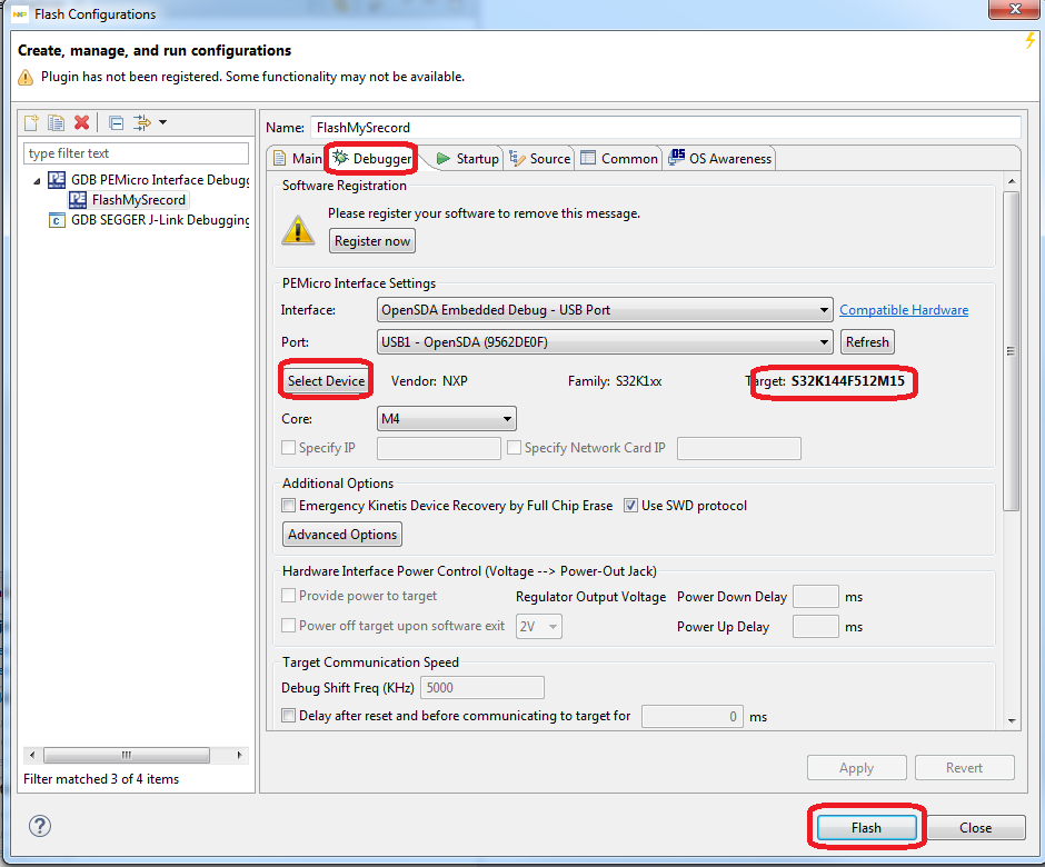

Could you be more specific about the debug interface you are using? (Segger/Pemirco Multilink/OpenSDA..)
I'd recommend you to install the latest version v1.3 :
S32 Design Studio for ARM v1.3 (Windows/Linux) released!
The latest version includes flash configuration that you can use to program your elf/s-record to the MCU.

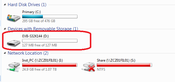

With OpenSDA interface you can program your binary s-record file by drag&drop the file to the mass storage that appears when the board is plugged into USB socket.
Hope it helps,
Stan

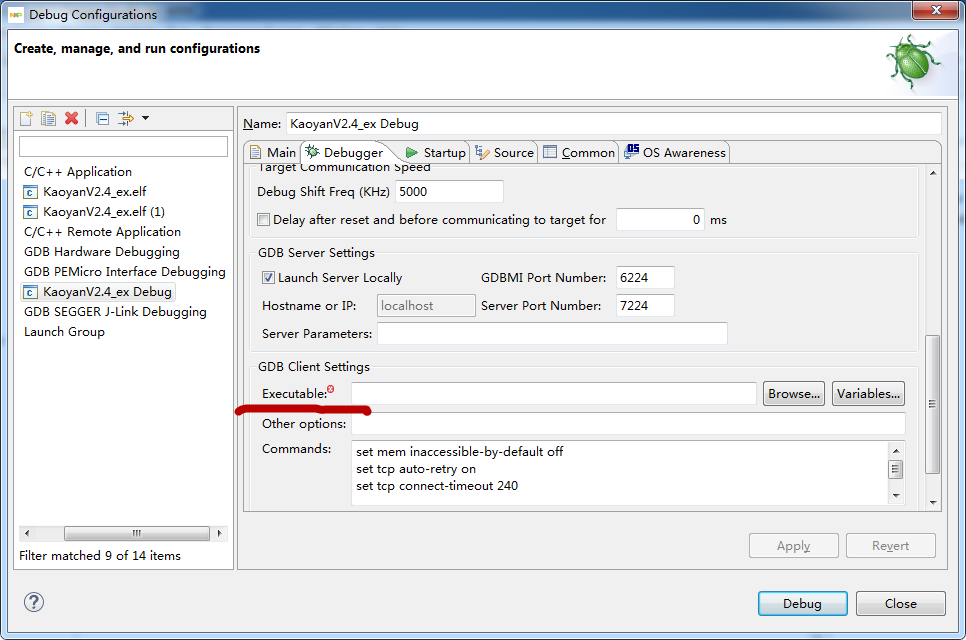

wuxiesi
Thanks for your help.I found the way to solve the problem in Help Contents,as your method.
the error may be caused by  lost the GDB Client Settings,when I add the gdb.exe path,it is gone.
Thanks again.

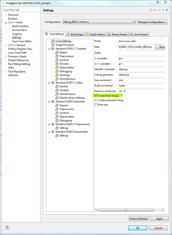

I have installed the lasted version v1.3,and follow your step.However,I can't find any file ending in '.srec'  in my project library.So, what should I do to creat a '.stec' file?
Also ,I try to execute the '.elf' file,and I will get a error like this:pastedImage_1.png

jiri_kral
to get srec file you need to enable it in project properties.
Right click on your project name -> properties -> C/C++ Build -> Settings
You can find srec file inside Debug/Release directory (depends on your configuration).
In which step you get the error message? During upload the elf file into MCU?
