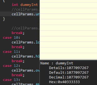

For example, I am receiving the data 0x40333333, it`s suposed to be 2.8, but the result is totally different.
The images below will help to explain the situation (the variable that I am focusing in this example is cellParams.underVoltage
- variable initialiazion
cellParams.underVoltage = 2.80;

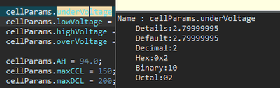

- initialization confirmation:

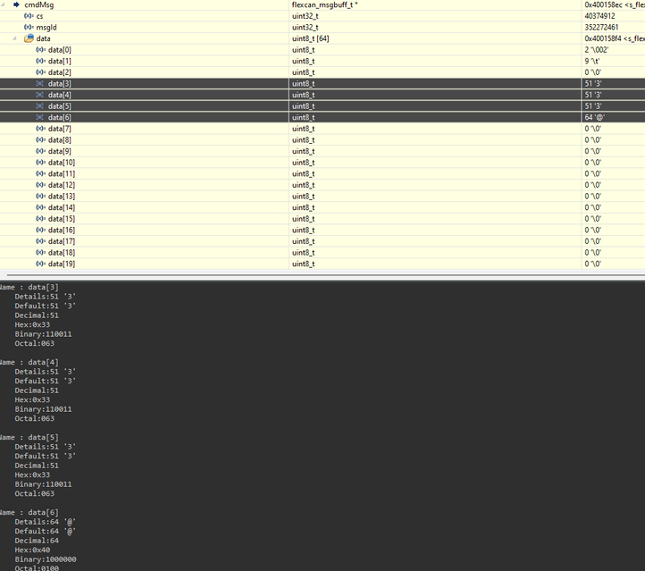

So after the initialization, I will send a CAN command to change the value (I will send the same value)
The new value is in the image below, from buffer position 3 until 6

int dummyInt = DeserializeInt32(&cmdMsg->data[3]);
//cellParams.underVoltage = atof(&cmdMsg->data[3]); (same problem...)
cellParams.underVoltage = (float)(dummyInt);

the returned value to dummyInt is OK:

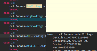

The float value, before cellParams.underVoltage = (float)(dummyInt), is:
And after cellParams.underVoltage = (float)(dummyInt), is:
but if I check the variable (not in memory monitor), the hex value looks fine, but the float value lookw incorrect:
