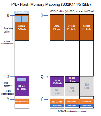

From Data spec of S32K144, I only understand there is 512 KB of flash and 64 KB of system RAM.
But from one of reference manual of S32K144, I got below screenshot which I am not able to interpret. Can you please provide more information if you can please ?
Referring to below screenshot, I know PRAM is of 128 Bytes.
Mohan

S32K144 has several types of memory. There are basic ones - 512kB of program flash, 64kB of SRAM and configurable FlexMemory - 64kB of FlexNVM and 4kB of FlexRAM.
On address X starts FlexNVM - without CSEc module used as Data Flash - and portion of Data Flash is used for CSEc module based on CSEc module configuration.
On address Y starts FlexRAM - used as a SRAM if no CSEc module and when CSEc module is used and configured FlexRAM is used as a EERAM for CSEc module.
You can find more details in reference manual (S32K1xx Series Reference Manual Rev. 4) on page 68 (memory types) and on page 85 - Security Overview.

As you mentioned S32K144 is having 64KB.
But as per the memory map xls.  SRAM_L (extends downwards)  1FFF_8000 SRAM_U (extends upwards) 2000_6FFF
This means the size is 61KB.
Where is the other 3KB pointing? Is it possible to use the other 3KB?
Can you please explain this?
Thanks..!
Harish G
10,537 Views
pranavshinde
2000_6FFF - 1FFF_8000 = 60 KB
Remaining 4KB is FlexRAM.
