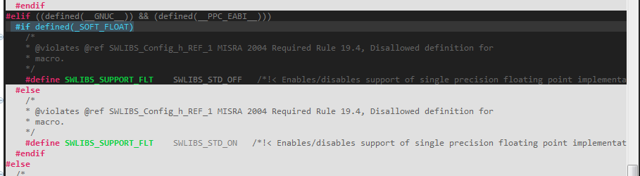

I'm trying to use AMMCLIB on a MPC5744P processor with S32 design studio.
My problem is to use the GDFLIB_FILTER_IIR1_DEFAULT_FLT who look like to be undeclared, it appear that all definition about this filter (type and function) are lock by this Line (in SWLIBS_Config.h) :

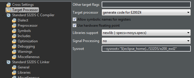

If I correctly understand this constant is define when the compiler doesn't use hardware floating point unit but in my compiler setting I've set the Use hardware floating point :
I've tried to change the signal Processing option but it doesn't change anything. Is Anyone have an idea on how to fix it?

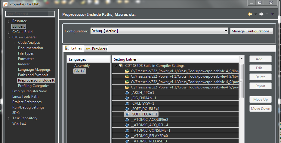

Hi Clement,
This could be the known issue that some internal compiler macros are not evaluated correctly by eclipse.
This should be fixed in the coming release v1.2.
I assume you are able to build the elf file. Am I right?
Stan

After a few research in S32 I found this constant in the project properties but i can't edit it... Do you know when the next release will be available?

clemNantes
Here the problematic constant:
