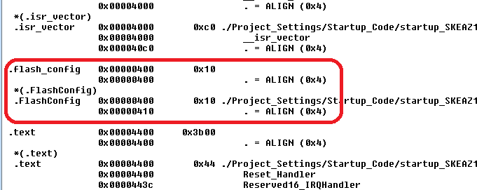

Thanks for the files.
Your elf indeed includes 10 bytes in the flash section below:
  FLASH_CONFIG     (RX)  : ORIGIN = 0x00000400, LENGTH = 0x00000010
see the map file snippet:
I'd suggest you to remove .FlashConfig section ./Project_Settings/Startup_Code/startup_SKEAZ1284.s :
Hope it helps.
Stan

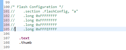

jackeyhong
Hi Stan,
Thanks for your advice.
I followed your suggestion to remove “FlashConfig” section in file “./Project_Settings/Startup_Code/startup_SKEAZ1284.s”. But the App didn’t start to run yet.

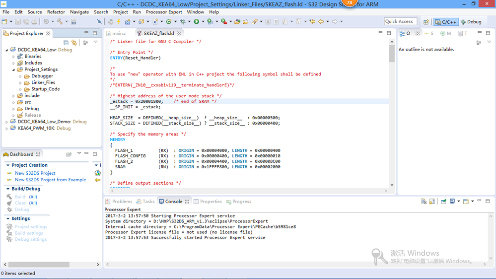

I try to debug my App. But it stopped at the beginning as following screenshot.
The problem is my App didn’t run with the “SKEAZ_flash.ld” that I modified to adapt BootLoader while the App can run with the default “SKEAZ_flash.ld”.
I attached the project of my App. Would you please help to check?
Many thanks.
Jackey

stanish
Your App should not overlap with bootloader if Flash memory.
I noticed there is a memory region FLASH_CONFIG that starts at 0x400.
I suspect this may cause flash programming issue if your app has some data at this address. You can find this info in .map file generated by the linker.
Hope it helps.
Stan
