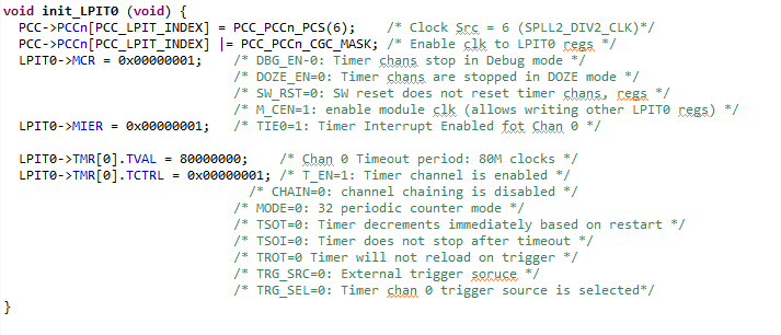

while starting a S32K Project by default template, i receive another S32K144.h file in include dir, then starting an example Project (e.g. hello_Interrupts).
So if i copy paste the code from the example to my Project i get some Errors while build?!?
Which S32K144.h file now is the right one?

Hi Adrian,
The non-SDK example projects are based on the older version of the header file (rev. 1.5, 2015-09-16).
Whereas the new project in S32DS v1.3 includes newer header file (rev. 2.5, 2016-11-25)
I'd suggest you to use newer version of the header file and adjust the source code accordingly:

Hi Adrian,
the version of S32K144.h file depends on SDK version chosen for your project (SDK_EAR_0.8.2 / SDK_BETA_0.9.0 or other).  The errors may by caused by bad indexing. To fix it - right click on your project name -> index -> rebuild. Hope it helps.
